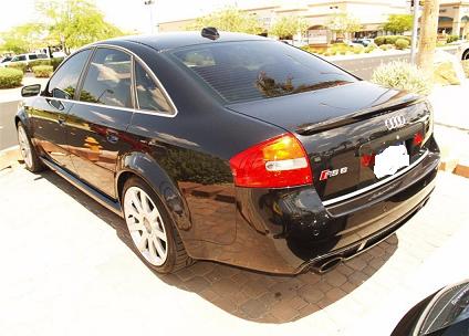

Do you have any pics of your RS6?

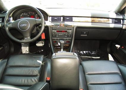

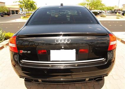

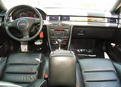

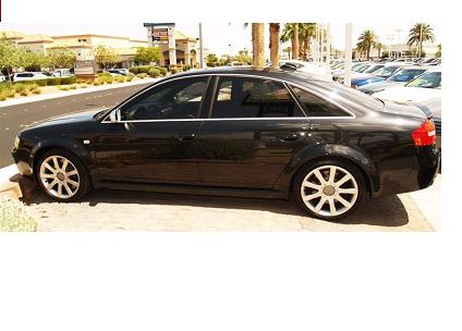

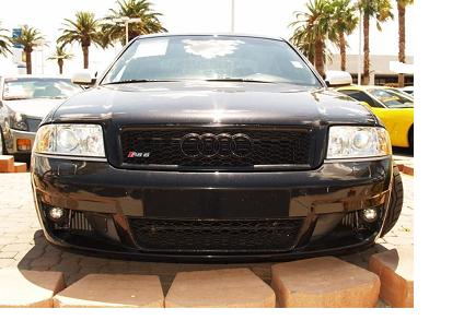

Enclosed are some pics..not sure what happened to my last account..it all of the sudden didn't recognize my password and after asking to reset it several times I get nothing..maybe just email lag..who knows.

Your RS looks Fkin NICE man. love the blk/blk
I want to get all of the silver trim on mine painted flat black soon..
