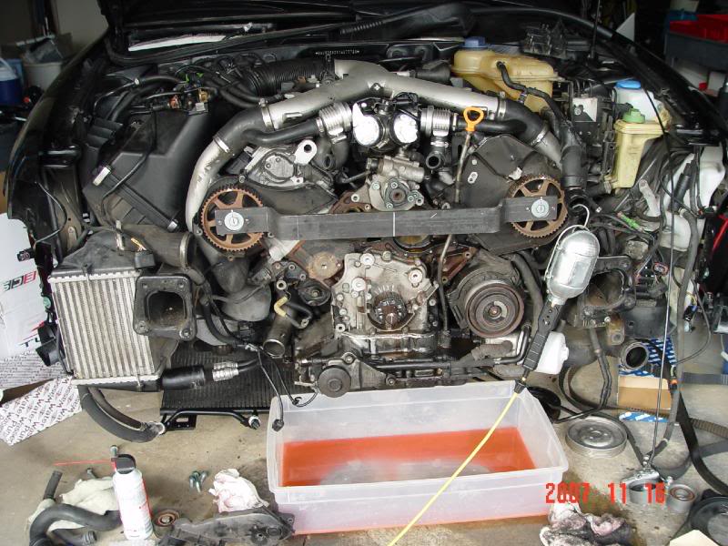

the only special tool that you really need is a cam-lock bar. i homebrewed my own version for $10

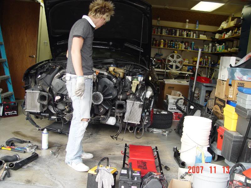

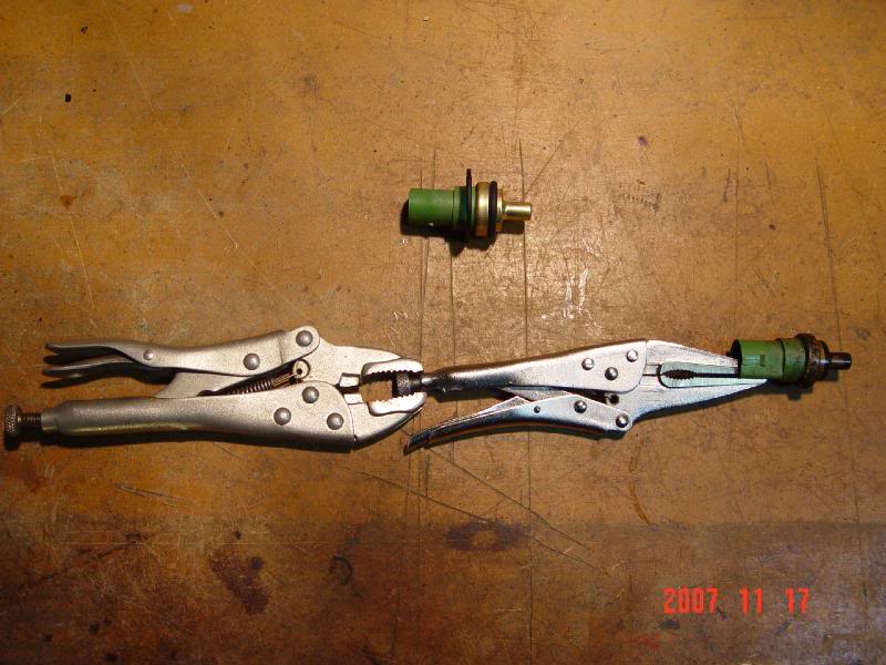

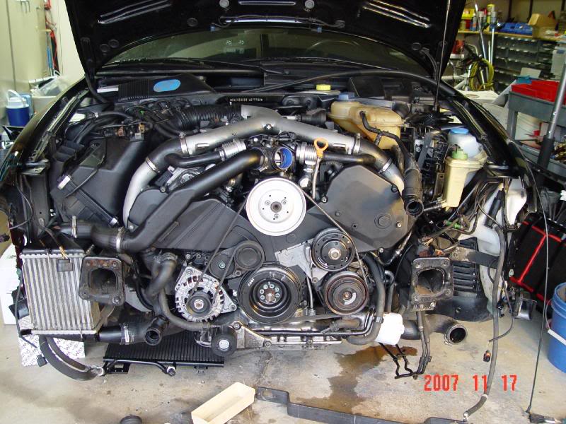

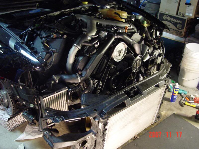

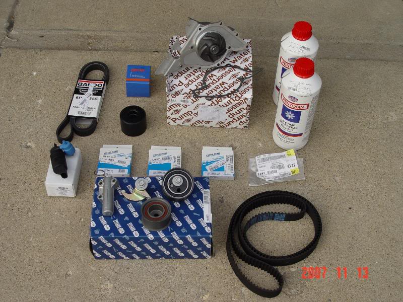

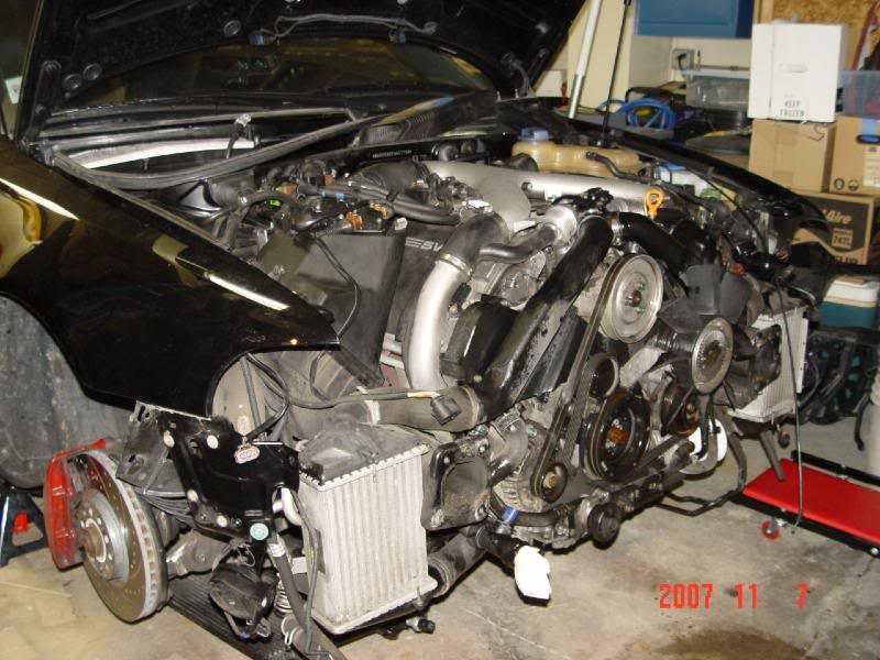

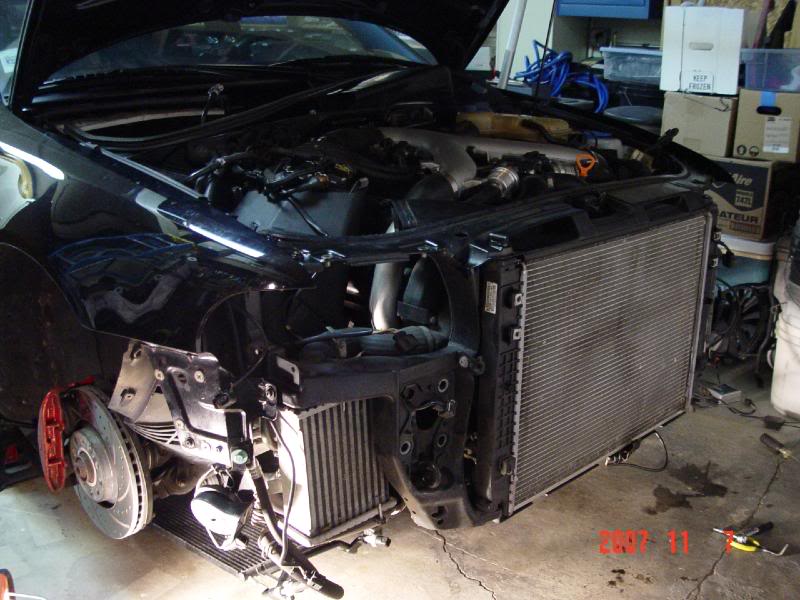

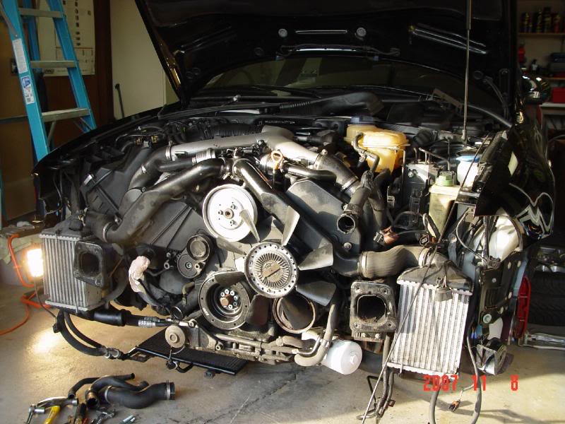

screw that high price.. do it by yourself. buy the T belt kit on ECS for like 400$ and install everything yourself.. the only tool you really need it the cam locking bar..
I did it alone and im 18 im just wrench handy i guess.
And no i didn't know wear that when working on the car. i just wanted to show my friend something and not get my hand dirty.
