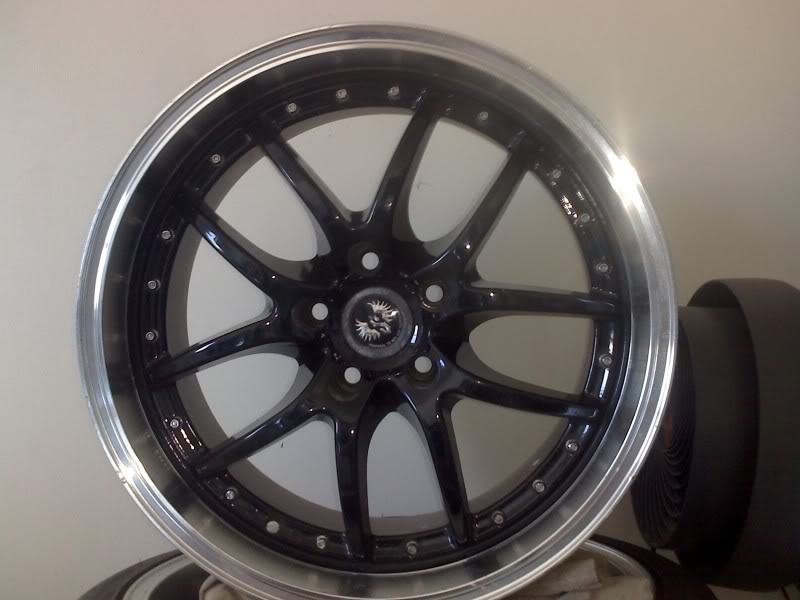

Hi I just picked up a 2000 black on black tip. I am seriously considering getting these black rims to complete the look.
http://tinypic.com/view.php?pic=dw48c6&s=3
They are 19x 8 sized and I was told by the seller I would need 235/35R19 tires. I want to make sure they would fit with no rubbing. Also would I need spacers or special lugs? I would also like to hear opinions on if a 19” rim would give a bad ride or a noticeable difference in performance or handling.
Thanks for any help or opinions.

on the pic it says they are 20' and that the s4 is not labled as a car it fits. what is its lug bolt pattern, you need to know that for the lug question. Also spacers are a yes for that big and wide.

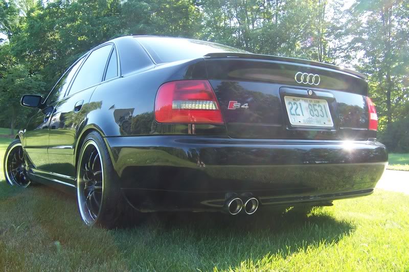

Bolt pattern is 5x112, 35mm offsett works well.
Theres alot of black wheels with a chrome lip(I have Sterns), and on alot you can put audi centercaps in (those arent audi wheels). I dont know if you have your heart set on those specific wheels but if you can id get those in 18x8.5 , or find a different wheel in 18x8.5 with 235 wide rubber
On Car
Brilliant Black FTW
The polished/chrome lip is necessary on a Black/Black/Black car IMO

Thanks for the quick replies. I know these pics are of 20s but I spoke to seller and they come in a 19x8. He said they also have an 18 but would not get them back in for months. The seller said the 19's would fit a B5 S4 for sure. I really do like the look of these particular rims, but I am open to other options. It was mentioned that there are other wheels which would take Audi centercaps (I know these are not real Audi rims). Could I have some examples of black w/ polished lip that would work with the center caps? On another note is it general consensus that 19's are just too big for our cars? I don't want to lose any performance or handling but I do want the wheel wells filled. Also I guess it is always better to have a wheel that is wider (8.5 as opposed to 8") no? I'd like to hear all thoughts and opinions.
