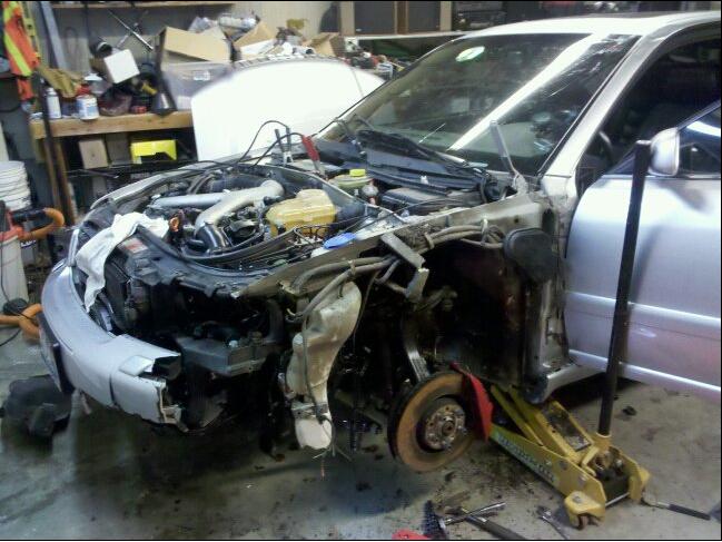

so here it is... im looking for help mostly in trouble shooting the electrical or figuring out why it will not start. if i can get the car to start and run then i can fix the rest later. when i turn the key the motor turns over just fine but will not fire or spark. i have been told this could be due to the fuel pump relay. or many of the other relays that were under the dash and got wet. along with the ecu... im currently hoping for some advise on where i can send my ecu to have it tested if anywhere? or if maybe someone in the area with a 2001.5 s4 wants to stop by and let me plug it into their car and see if it works. im located in coeur d alene idaho. the car is currently in my garage with the front bumper and front drivers side fender removed. they are the only parts of the body that received major damage in the accident. im really looking for any and all advise of what i need to check/clean/replace/etc and what the best methods of this are. thanks in advance everyone. please feel free to ask more questions. i also have more pictures too!

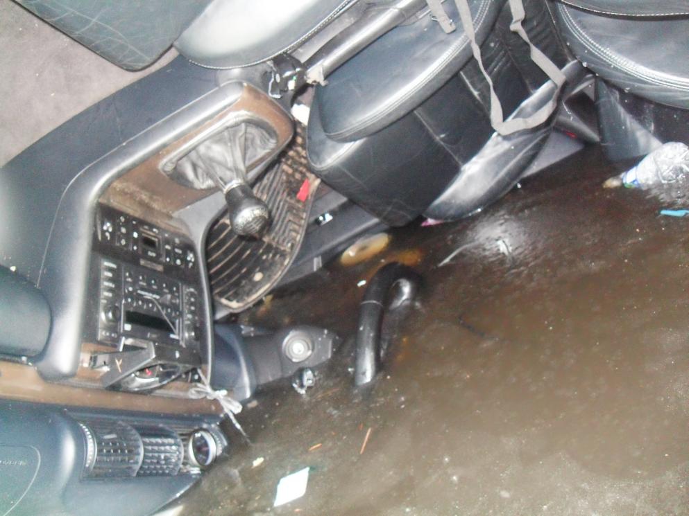

yes i know it sucks. when i turn the key the motor turns over but will not fire. no spark. i drained the oil, it looked old but not watered down. replaced the oil, not sure if all the gas drained out or not, suppose ill check that when i get home. really the only thing that didnt get wet is the passanger side. about 1/4 of the car was under water and it was the drivers side where all the fuses and what not are including the ecu etc.

The ECU is sealed up pretty good so I wouldn't expect there to be any water in there. I'm guessing the whole fuse panel was submerged so the extent of the damage could be pretty far reaching. With everything that got wet I would suspect water in the engine (intake, heads, fuel, etc.) Also, could be an immobilizer issue, ignition switch, fuel pump (fuse)...

--I thought this was true as well until i further inspected and started taking things apart. apparently there is a hole that goes from the BOTTOM of the ecu box down into the cabin of the car. this usually would not be a problem except the car was on its side and the whole drivers side was under water which means that the water had no problem leaking into the ECU box, in fact, when i opened the ECU box there was indeed a puddle of water in the bottom corner of it, which has since then been cleaned up.
yes the fuse panel was wet and today i plan to check all the fuses and other things such as the fuel pump relay to make sure they are all in working order.

so far i have had the intake manifold off to ensure that there is no liquid in there, everything looks good. also the drivers side intercooler is missing as it was damaged in the accident and im not wanting to replace it till i can actually get the motor running.'

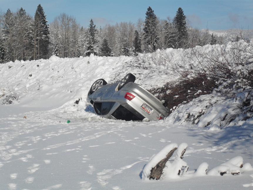

this happened on a road that was complete ice and i was trying to go around a corner and for some reason the damn car went straight, i thought this was very weird as i clearly remember a time or twelve that the traction control saved my *** from getting in a wreck... WHERE WERE YOU THIS TIME ESP!?!?!?!
