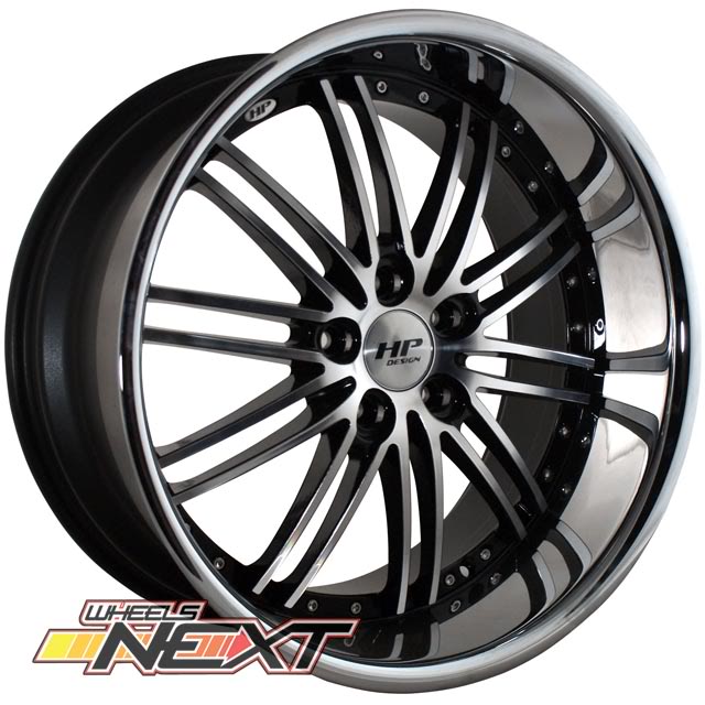

If i go with 19's can i fit a 8.5 width without scrubbing? these are the wheels im thinking about getting.

Depends on the offset. I had 19x8.5 with 245s and it was fine (35mm offset). Then I upgraded to BBS of the same size and they rubbed (32mm offset). So, just 3mm can make the difference. I have a B7, btw, so your exact specs will be different. My point is just to pay attn to the offset. Also, looking at this rim, I see them bending a lot. I had a similar type and bent 3 of them before giving up and going with single-piece, forged BBSs.
