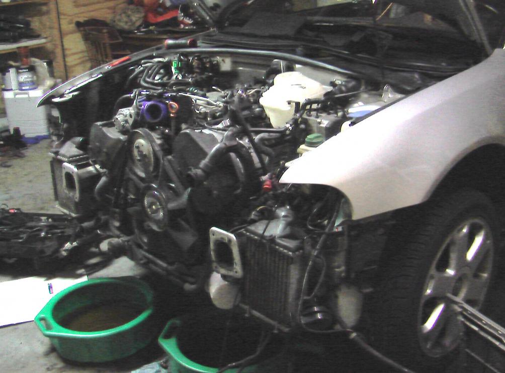

here are some pics and ill add more the further i get into the project..
wish me luck!!

okay, so ive got my intake manifold off just to make it easier to get to some of the engine tranny bolts and dp nuts. was just looking at the manifold and where it bolts on to the heads.. it seems like the heads have an enormous area that can be ported.. has anyone tried this? can you port the heads or is it not worth the trouble? i also see that i do not have a ton of space on the intake itself to port.. maybe a few millimeters or so.. but im also guessing that if i do likewise on the head side itll reap much more beneficial results...
kinda odd.. tearing this beast down.. i accidentally broke the maf internally, was pretty pissed then remembered that i have to get a different one anyways.. lol...

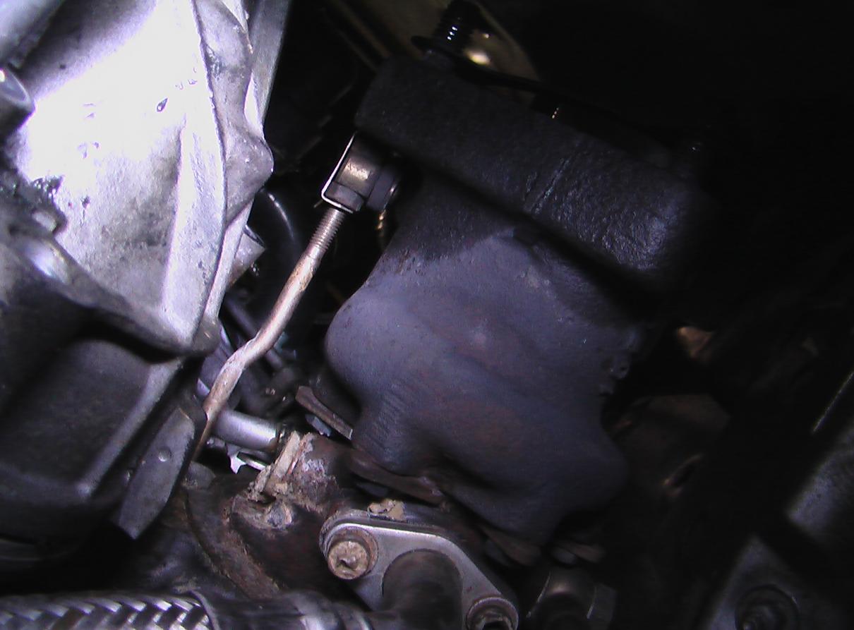

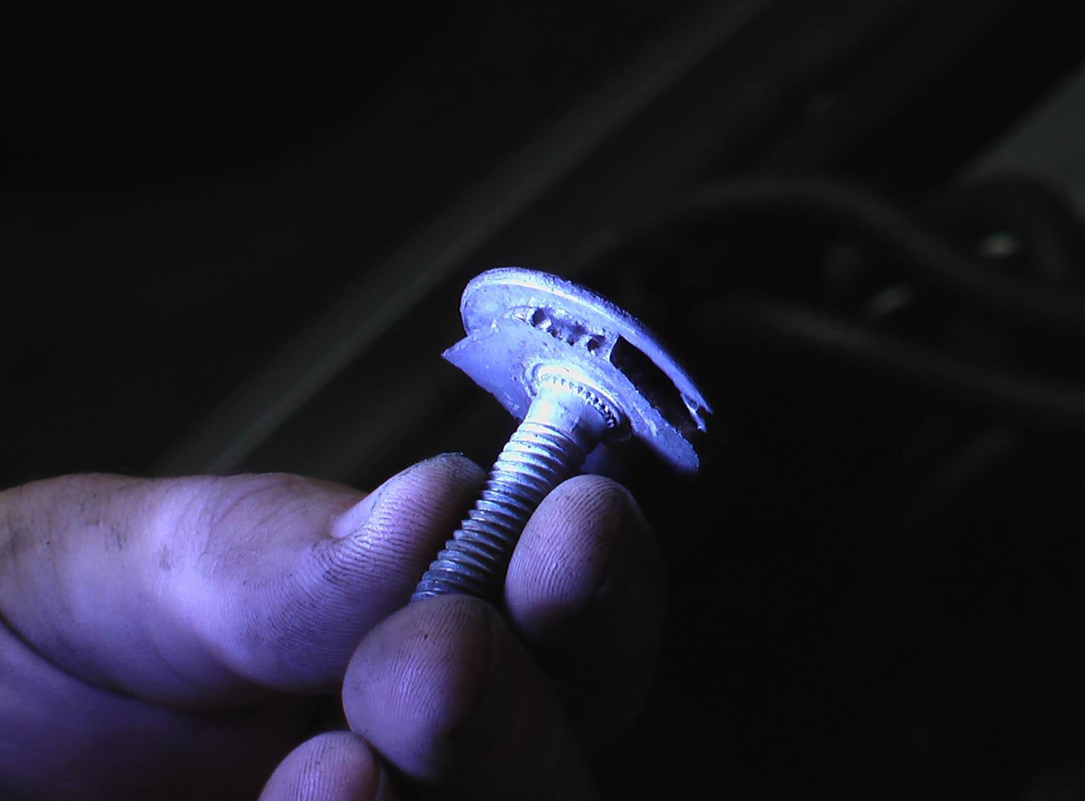

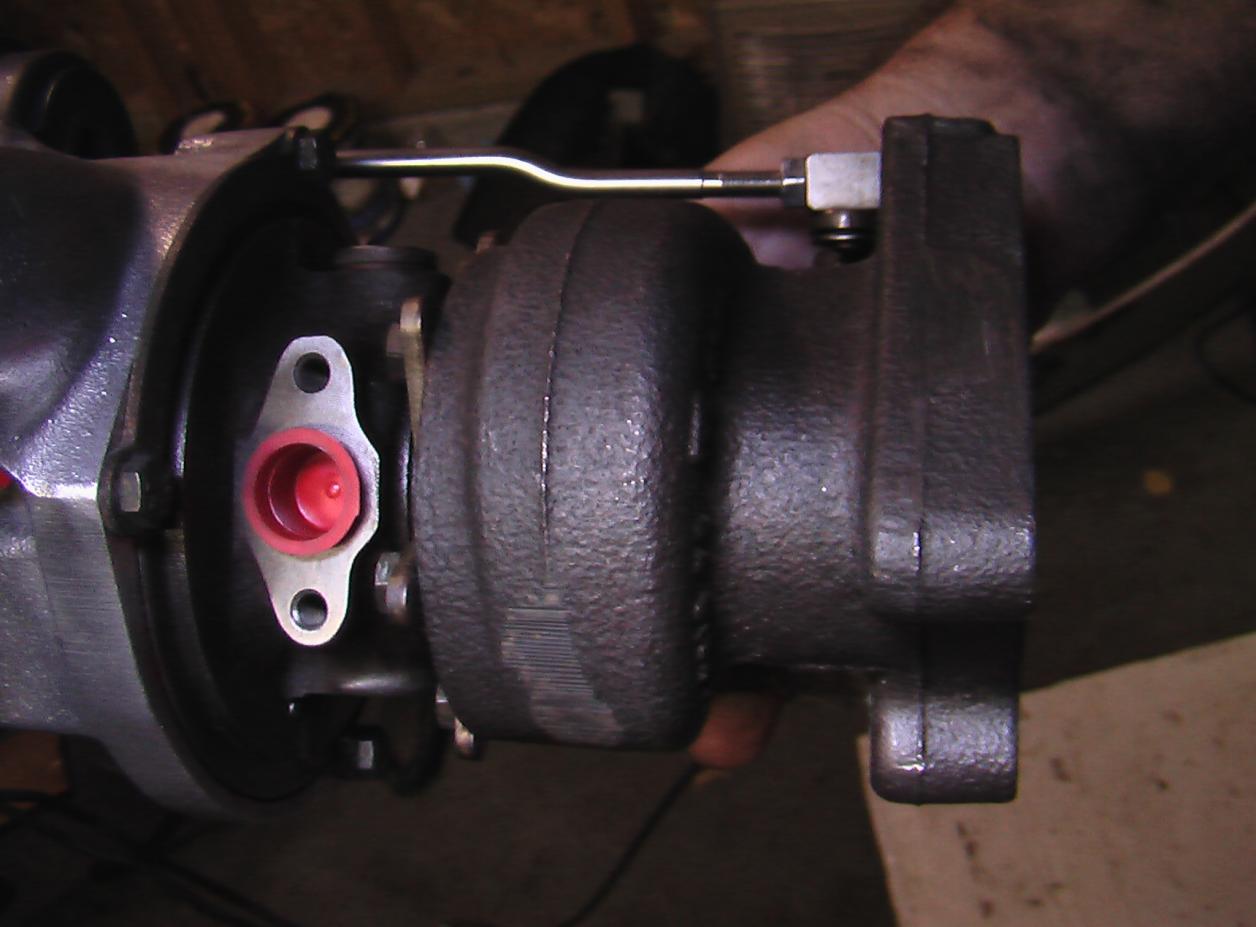

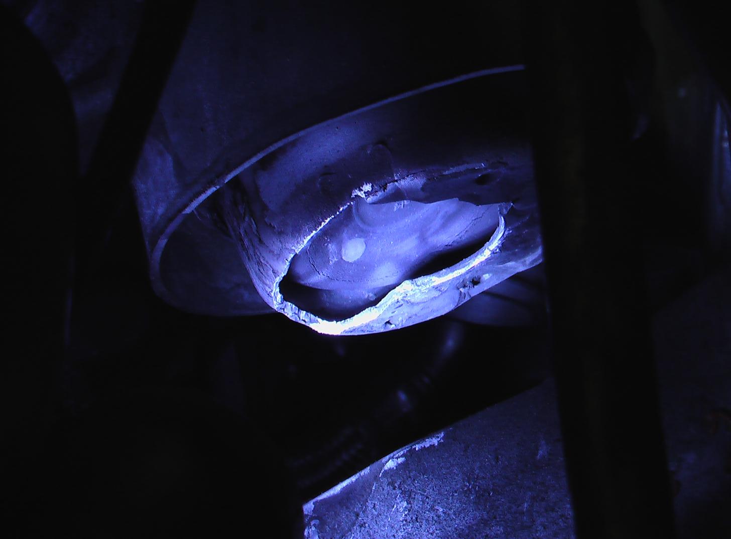

okay. so i got the engine separated from the transmission and just staying caged due to a few bolts left loose but in.. here are a few more pics of what im doing now..
look at that busted mount!! wow.. thats where that snap crackle and pop was coming from ..
and notice the hot side difference between the k03's and the rs6's.. i mean.. thats crazy.. enormous difference.. i could do an enzyte commercial or something..

These stock heads are pretty much at maximum flow and porting them will decrease flow most of the time if you do not know what you are doing!

The mount looks similar to mine when I pulled the motor
