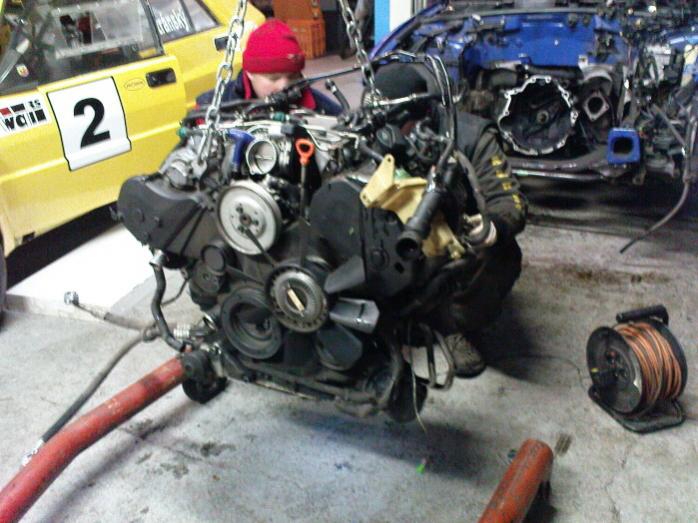

I am verry sorry about new topic there, I asking about set of RPTurbos (JHMotorsports) if they are good or not.
I have engine out...

few fotos from service of my czech audi
Attached Thumbnails S4 B5 - my turbos are dead...which turbos now? K03 or UPGRADE-1.jpg   S4 B5 - my turbos are dead...which turbos now? K03 or UPGRADE-2.jpg   S4 B5 - my turbos are dead...which turbos now? K03 or UPGRADE-7.jpg   S4 B5 - my turbos are dead...which turbos now? K03 or UPGRADE-12.jpg
