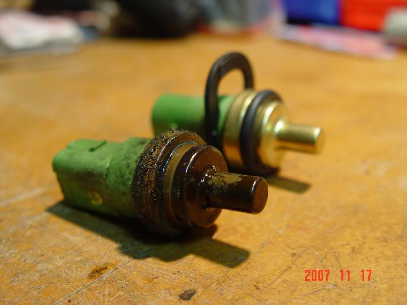

Old Dec 23, 2007 | 03:09 PM
ARIaudiS4's Avatar
Joined: Aug 2007
Posts: 198
From: Chicago, Illinois
Default RE: s4 coolant sensor location
no problem, it took me a good 30min to locate the sensor haha everything looks the same from the top. I bought the green top and then i found out that i already had a green top on my car, but thank god i pulled it out the old one was NASTTYYYYY . corroded and everything

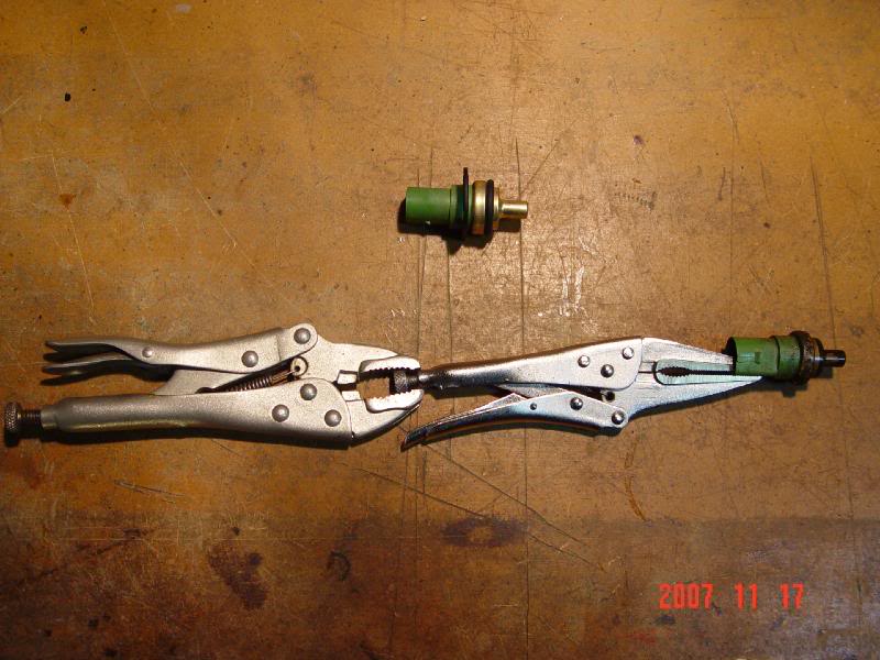

ok found it... unhooked the wiires but can't get the stinkin thing out? any special tools??
Old Dec 26, 2007 | 08:11 AM
sweeds4's Avatar
Joined: Aug 2007
Posts: 981
From: Boston
bump.. yes the clip was out. I tried pulling it out with pliers. and no good... one guys (at firestone) told me to use oil to lube it up, not sure.. any help please??

Old Dec 26, 2007 | 08:58 PM
ARIaudiS4's Avatar
Joined: Aug 2007
Posts: 198
this is how i got it.. alot of force and alot of corrosion
