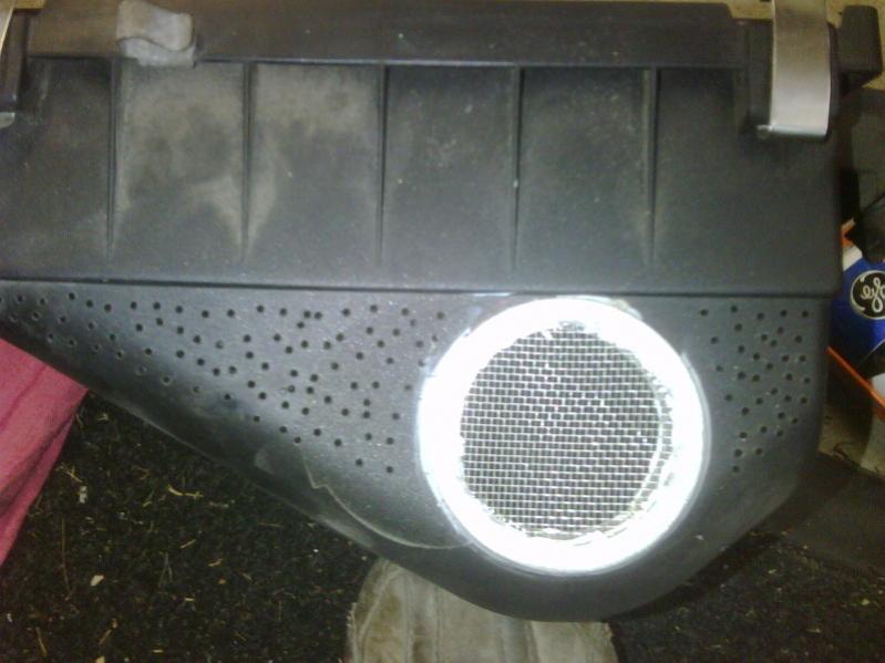

U guys r sick of this but, did my darintake less then 15 min. looks better then alot iv seen, not all just alot, no z flow or anything. i drilled 1, 2.5" hole in bottom, bent a 2.5" silverring thing with a screen i got from homedepot in the plumbing sec. 4 bucks. sealed it up with silicone great results can feel the quicker throttle respons, can hear the turbos a bit more. i think i did a great job looks good n clean too (proud) iv been procrastinating on this one glad i finaly did it,

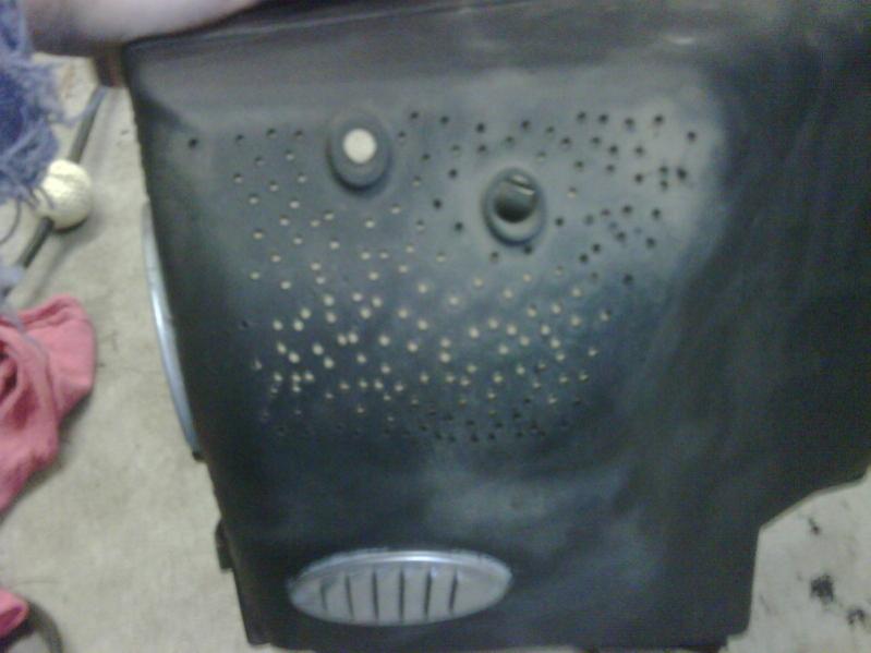

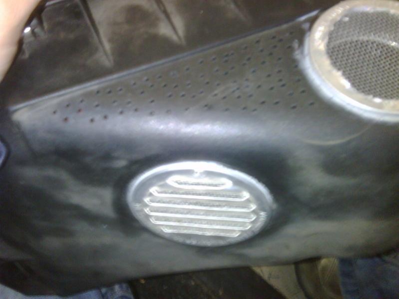

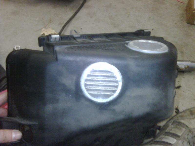

These are part of a thread i posted a few months ago.
I just used 2 vents. One i removed the venting from because i was less concerned about hydro-locking in that area (headlight is in the way) And The other one on the bottom i left the vents on facing the flow direction i felt utilized the air best and decreased the chances of hydro-locking again.
I used a 1/16 drill bit to add flow. I know it looks like a lot but i sprayed this box with a garden hose from 2' away. Even with the pressure of the hose, minimal water penetrated.
