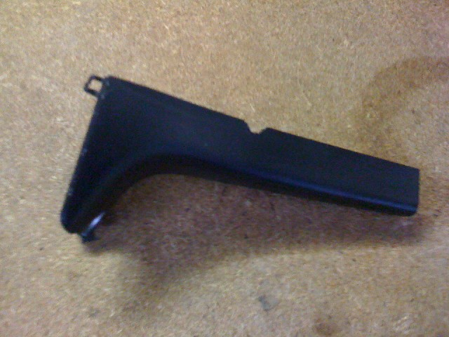

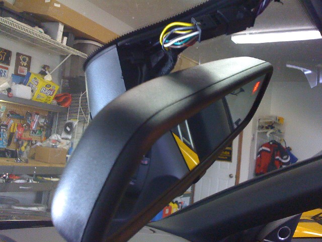

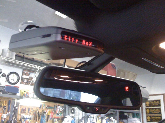

I hardwired my Escort 8500 to my S5 mirror.

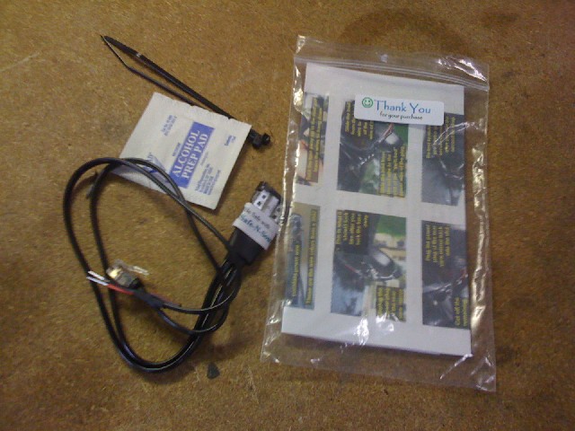

- Found a fused hardware kit on eBay.
- Removed the mirror spine cover and used a Dremmel to cut a small notch.
- Tapped the black for (-) and white for (+) which is a switched 12V. You should test with a meter on your car to verify.
Works great, no wires on the dash or run through the trim to fuse box.

As mentioned above, I tapped the black and white wires for a switched 12V...see 3rd photo. Still working great and very clean install.
