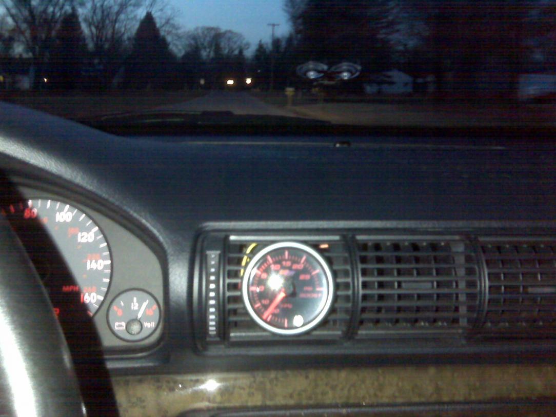

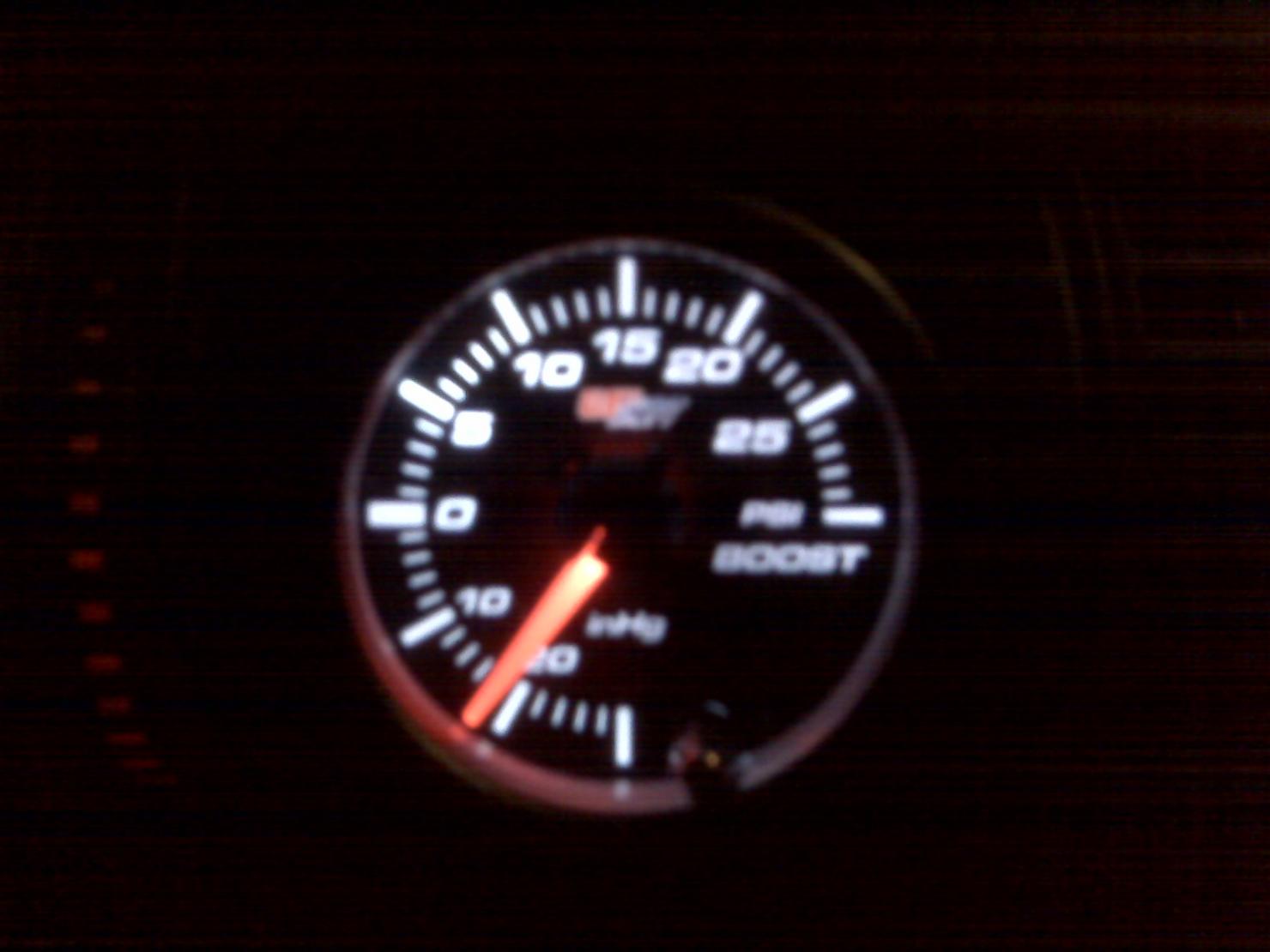

pop the center vent cluster out of the dash...
remove vent of your choice from rear of cluster.
use tin snips/wire cutters to take out a good portion of the center of the vent.
dremel down each bar to the appropriate size of your gauge so that it fits tight and holds in there.
its free!! I did it, super easy, holds great, and with a lip on the gauge face, you cant see any imperfections in the vent....
