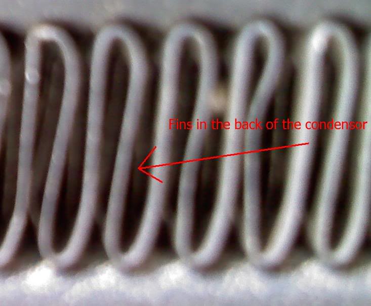

My fan turns about 1 to 1 1/2 rotations by hand before stopping. It also doesn't turn without squeaking. I'm guessing that's probably where the problem is, unless my condenser isn't supposed to look like this:
Are the fins in the back of the condenser supposed to obstruct the airflow from the front fins like this?
Could I safely use a higher amperage fuse as a temporary fix? Would it be likely to harm anything other than the fan itself?

I cant figure out whats in that pic.

The pic is of one of the rows of fins in the condenser.

So anyone know if the fins in the condenser are supposed to look like that?
It may sound like a dumb question, but it just seems like they restrict a lot of airflow this way.
