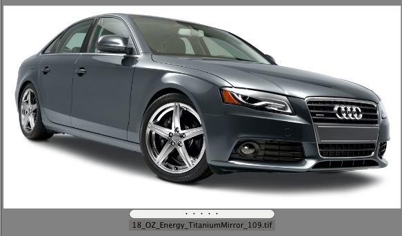

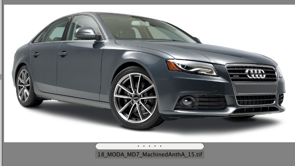

The move to an 18'' will stiffen the ride a little bit if you keep the stock height, which is recommended so you don't have any speedometer or odometer problems. That tire size would be 235/40R18. There would be no rubbing issues with that size.
For wheel size an 18x8 or 18x8.5 would fit well. I would recommend staying with an offset between 30 and 40. The lower offset will give you more of a deep dish look.
As far as looks go, if I may generalize, people tend to like to see a shiny wheel instead of a black tire sidewall. In the end it comes down to your preference more than anything. I'll dig up some pictures for you so that you can get an idea. Of course you can always use our resource online to see the vehicle profile with our wheel options on it:
