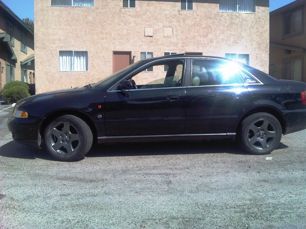

well here is my failed attempt at cool rims lol.. it started off fine... then a breeze happened in the middle of it... got some over spray on the tires... dont know if u can tell from the pic.. but its there lol.. anyways her it is lol
bleggh... looking at that pic i really need to get lower haha i HATE wheel gap... anyways i finished the other 2.. ran out of the gun metal though lol.. so i jsut went a lil over board with the clear coat hhaha hopefully it works.. either way urs looks a lot better than mine.. butit only took me like an hour to do mine as opposed to the 5 it took u... i kinda rushed it as it was 106 out today lol
