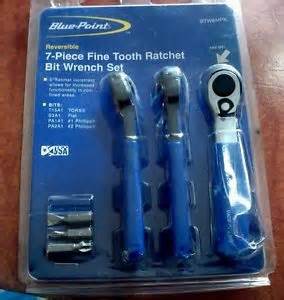

I'd get a combi-valve (or valves) from a non-dealer vendor (check ebay, one of the places that advertises here, etc) and then either replace the parts yourself or find a good indy shop that can do it. Be sure they're familiar with European cars. Used parts are OK as long as they can be verified as GOOD used parts before installing. Pump can be tested with jumpers and the valves should not flow without vacuum applied and should flow with vacuum. They can fail either way (leak or not open at all).The pump is fairly easy to swap. The combi-valves are a little more of a PITA due to the location. You need a small allen bit and ratchet driver for access pretty much. Not a 1/4" ratchet but a ratchet bit driver tool. Be sure to carefully inspect the vacuum hoses or better yet, replace them. On that I'd really recommend the OEM style hose with the braided covering vs parts store stuff. The covered hose is one thing well worth the added cost, trust me.
Then change the fuse and start the car (cold engine). You should hear the pump run for a short time. On a 2.7L they make a racket, being mounted on the rear of the engine, right next to the firewall. Then the fault codes will need to be cleared. The light will go out on it's own eventually but normally would take 40 cold start/drive cycles (means cold start, fully warm and fully cooled again 40 times).
Here's what I mean by ratcheting bit driver:
