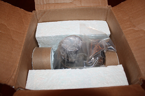

Peloquin LSD Packaging:

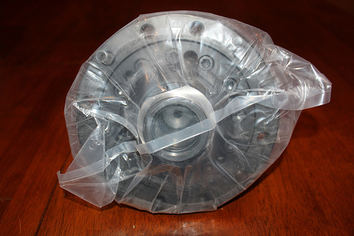

Peloquin LSD Hardware:

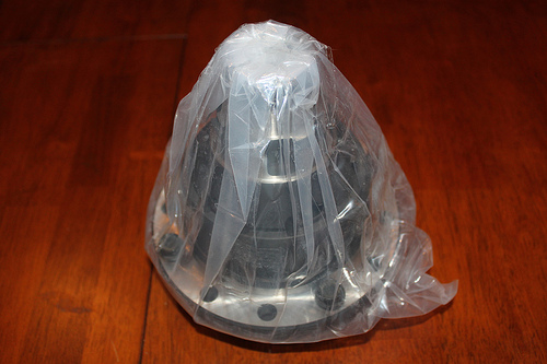

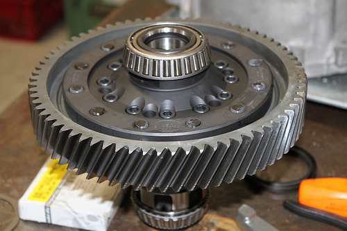

Peloquin LSD Unit:

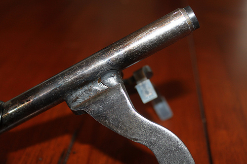

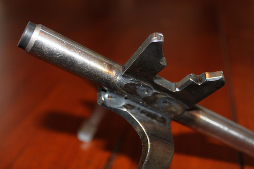

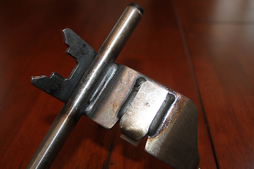

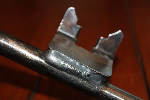

USP Motorsport Steel Shift Forks vs. OEM Bronze Shift Forks:
OEM Bronze Shift Fork Failure Points:

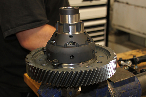

Peloquin LSD Unit:

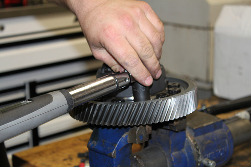

Installing the OEM Ring Gear on New Peloquin Limited Slip Differential:
Measuring New Peloquin Limited Slip Differential in Transmission Case:
