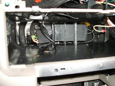

First of all I ´d like to say thank you to all of you for sharing this usefull information.
I´m going to upload some pic to complete this issue.
1. Photo: Relay position (behind storage box).
2. Photo: Relay holder (black box) with two metal sticks in each side. Press it down (carefully but with strength) and pull it to the right side.

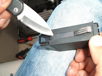

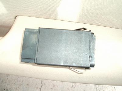

3 y 4. Photo: How to take the relay out of the relay holder (Black box).

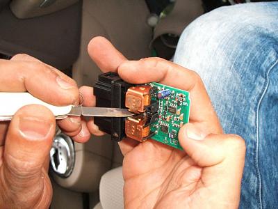

5. Photo: If you want to repair the relay, you can scratch carefully with something small lika a screwdriver (nanotechnology)
