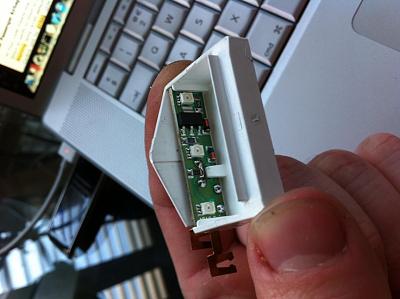

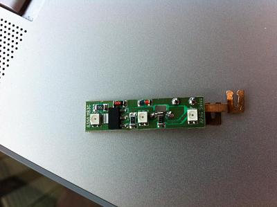

- removed the passenger side warning light from the ceiling cabin light assembly, re-soldered joints and tested for loose connections
By the way, I've attached pictures of the passenger airbag warning light, though I can not find the replacement part 6350 1183C anywhere.
I am pretty sure there is a bad connection somewhere between the airbag controller module and the lamp or the lamp module, but I am reluctant to pull anymore of the car apart in trying to sort this (minor) inconvenience out.

I "fixed" it by putting a 4K Ohm resistor across the passenger airbag deactivation warning light.

To clarify...
Workaround: Put a resistor in parallel with the bulb to shut the computer up.
Fix: Order a complete replacement light assembly from eBay and install it.
