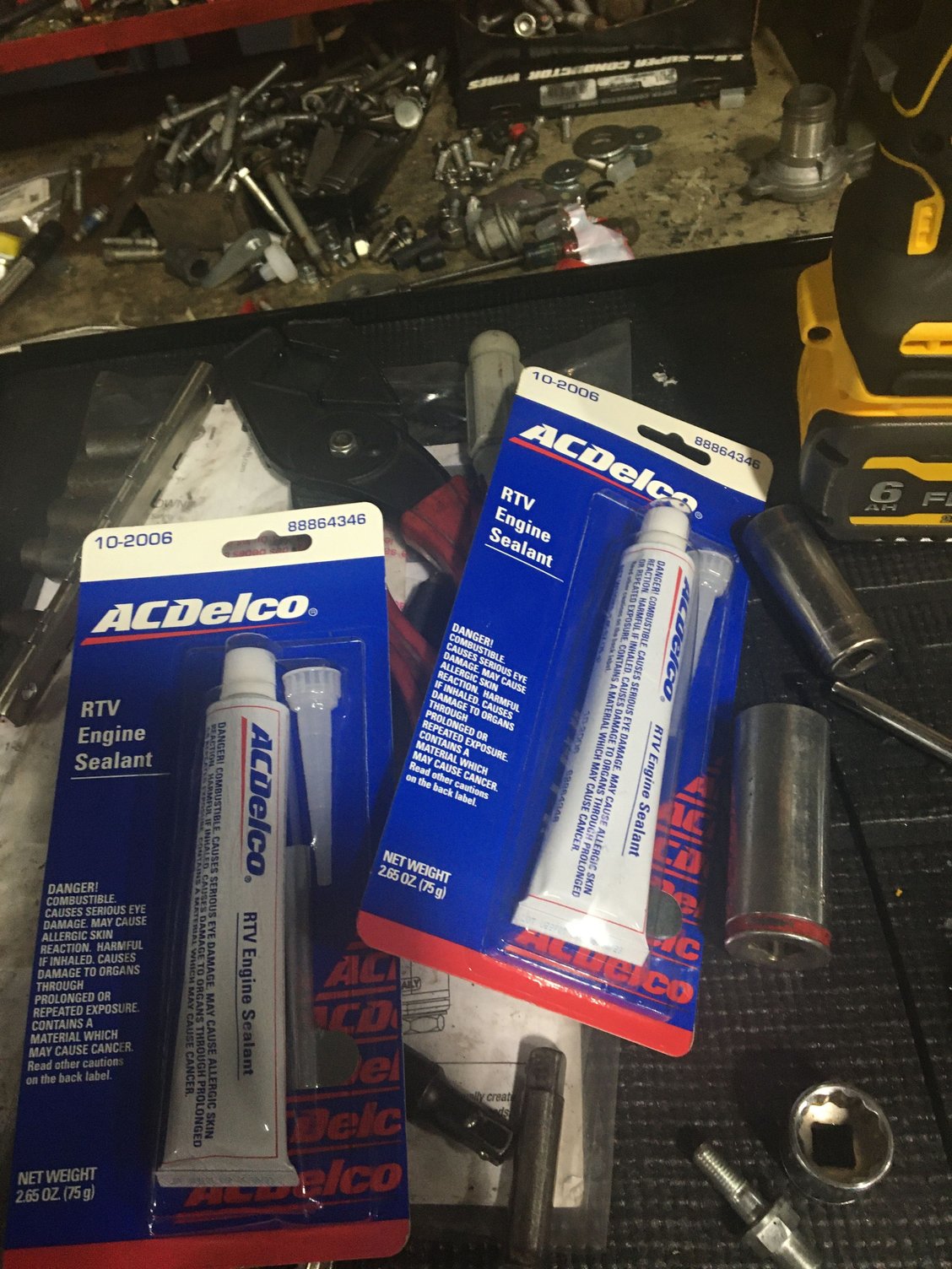

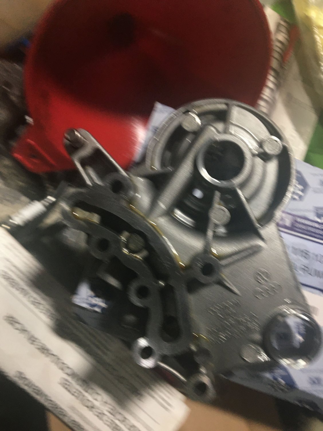

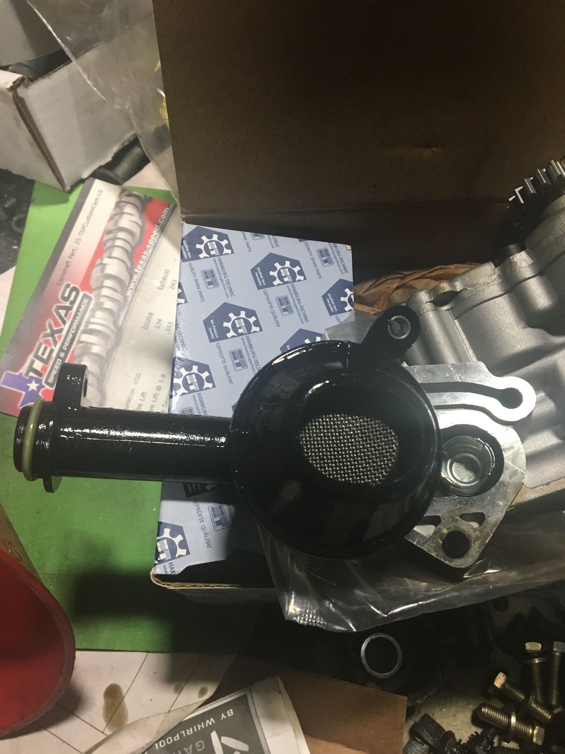

Thought I’d share this long day. My 11 A3 sportback manual fwd was purchased in 13 with 7k .I have a revo tune,after the usual downpipe exhaust intake clutch mods At 62k. After I heard the stories about the timing chain,and my corvette builder will work on the Audi as long as I wrench too.I wish I would’ve known a new oil pump chain didn’t come but everything else was there. They do love silicone over gaskets. I have 800 miles and two oil changes and three filters on the break in. I won’t break the site with a too many pics.I did the alternator.And cut open the first 200 miles oil change then after 300 miles I swapped the Wix for a Mann but will go for 2500 on oil. Easy oil filter swap.
