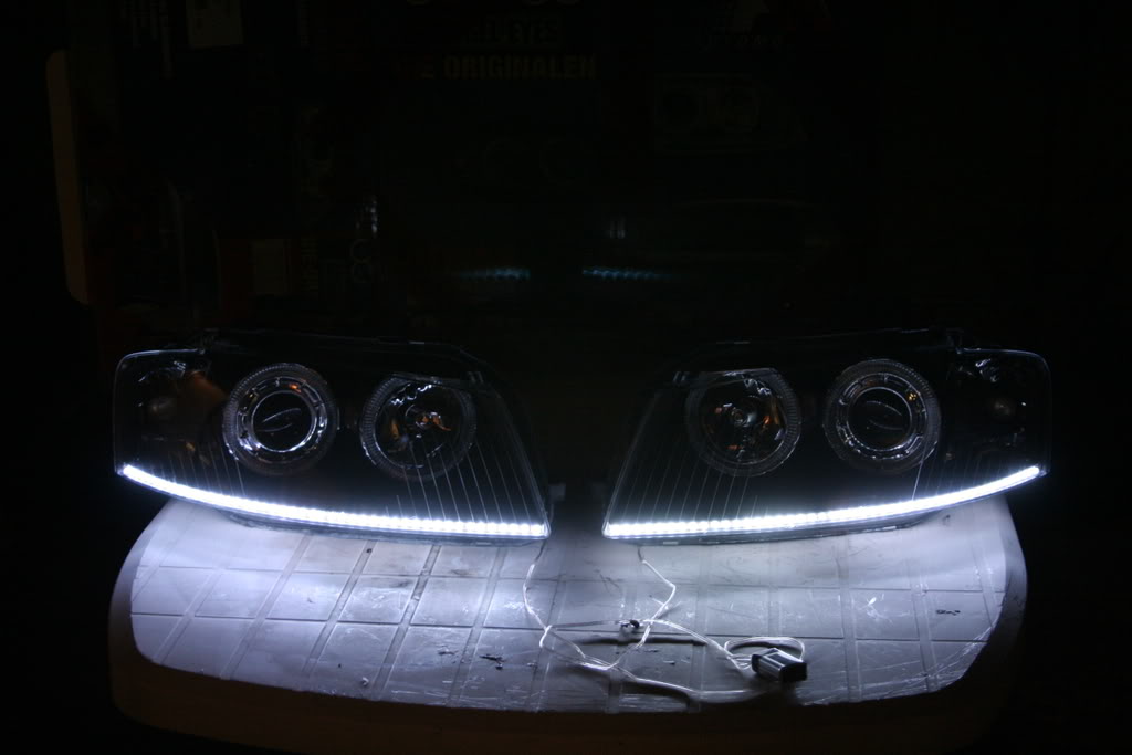

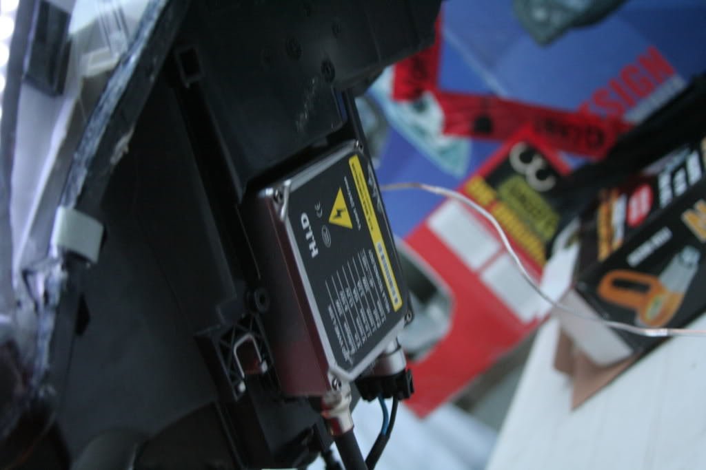

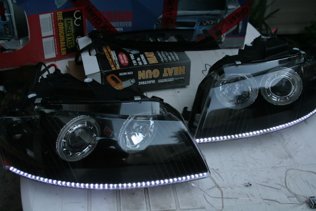

Hoping to get them installed this week... Just been busy and couldnt find time to work on them on the car. Anyways here are a couple of pics:

HIDs installed- ready for 'plug and play'

LED looks good. Nice work!
