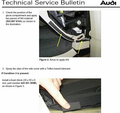

Default Problem sorted
Thanx for all the help and advice but I fixed rattle by following the audi bulletin..............see attachment....

hey stevo i think i might be experiencing the same problem. checked out your attachment but i have no idea where all that is. can u explain?
