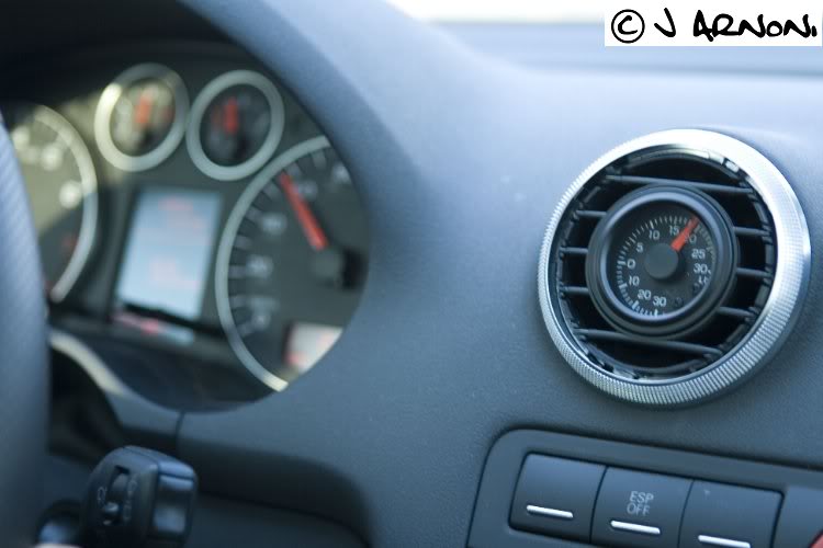

Ive had my setbacks with mine :-/ But I just love seeing the needle hitting 20
(I was fixing the guage so its missing the smaller plastic circle that borders the vents)

my AWE needle is a little off. [:@] is there any way to fix it??
