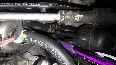

Got stuck in a parking lot today and poped the hood and herd a hising sound. I narrowed down the location and found that there was an air leak. Not sure what the technical names are for the parts shown in the pictures attached but I was able to temporarily fix the issue enough to get home. The part that's pointed to on the picture attached is the part I was able to return to the correct position to make the problem temporarily go away and get me home. I would just like to know what parts I would need to fix this issue. It doesn't seem to me that it would be that difficult of a task but I am sure it will be. I have had a check engine light on and got the diagnostics on it and got the code P2015. I was told that it was not a big deal and would just effect my MPG a little bit and that is was under warranty. I am SURE it has something to do with my new issue. Thanks for any suggestions.
Fist time post in this forum. I know it is not to technical but in a hurry and need to get this fixed

From what I gathered around the internet it points towards the Intake Flap motor and actuator. This seems to be a very common issue on the newer TFSI motors. If you are still within Warranty let the Dealership take care of this issue.
If you need DIY help:
DIY: Intake Flap Motor Replacement
If you are looking for the correct parts:
https://www.ecstuning.com/Audi-A3-Qu...old/ES2773483/
Good luck!
