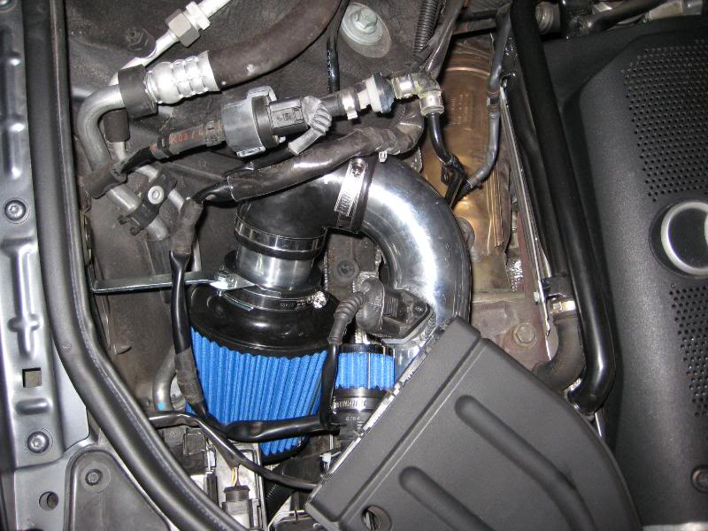

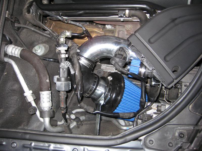

Well it was a sucessful day. Meet up with Bryan (Chaos) and installed my ebay air intake from max-speed motor-sports. Looks good, sounds great, inc. in torque.
We were going to install his FMIC but the front bumper had been riveted on so we need a dreamal to get them off.

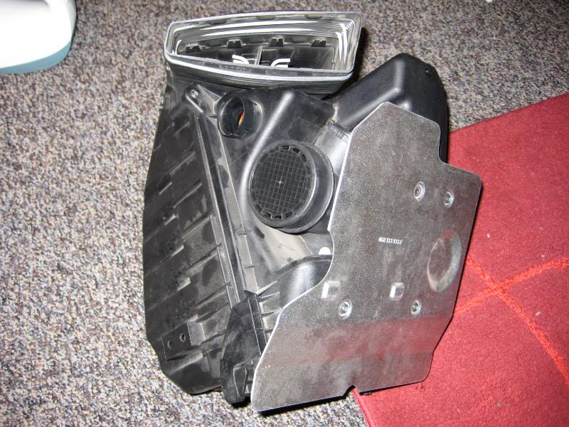

Heres what we took out..
and what we put in..
very easy to do
