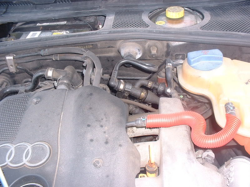

do you hear a hissing noise when you accelerate?
if you look above the red hose, you will see a bigger (looks dirty) hose that has a connection to it. I'll bet that unsnapped or you will need to get a new one. i had a problem with that hose, it would disconnect upon acceleration and making a hissing noise. hope this helps.
