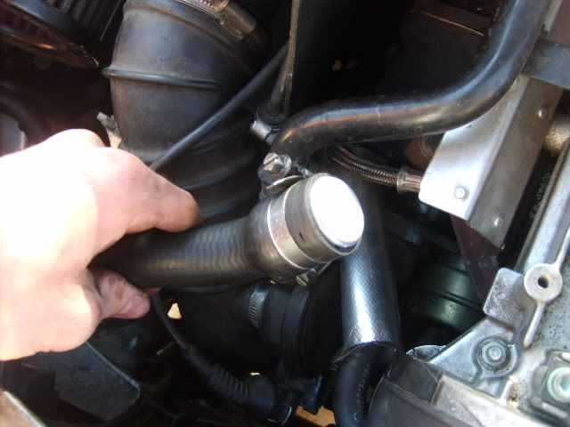

look at my thread (link is above) the b6 shoudn't be any different than the b5. you can either go at it from above like i did, or from below. most people find it easier to go from below but i didn't feel like jackin the car up.
just stand in front of your engine, look straight down between the engine and the radiator and a little to the left (passenger side) and look for this

huh? you just plug the hose going to the TIP or take the hose out and plug the TIP
