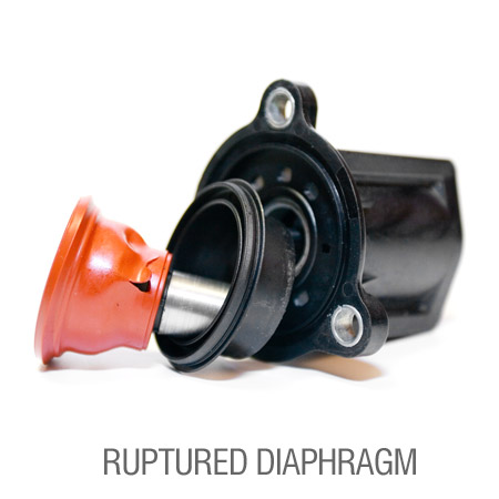

One thing that I am most concern is that:
1) On the dyno stock test result, the torque and rmp are climbing in harmony, but when the stock diverter fails, the rpm drops, some will notice this and some will not, and will get accustomed to the drop, not realising that the stock diverter has already raptured.
I got these pictures from ATP turbo, which provided a clear picture of my debate.

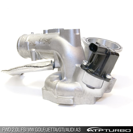

Here is what the diverter looks like.
Below is a ruptured diaphragm, from the stock motor.
There for the stock DV will not be able to do its job all alone, because no matter how we see it, it needs ablow off valve upgrade.
Here is the disclaimer from ATP turbo:
Custom machined sleeve to properly block off and disable function of the stock (electric) diverter valve on the 2.0L FSI turbo engine. Eliminates boost leaks at the valve and regain the pressure loss resulting from deteriorating diaphragm in the valve. (More into the subject at ATP.com)
Here is a clear picture of this subject.

most people get a new dv when the chip their car for this very reason. what are you asking? a dv and bov are the same thing. its weather or not your recirculate it or not.

That is the intention of this thread. The stock BOV, I doubt it will last long, that is why I am replacing it. Or will the stok one's last up to stage II? Sorry tobe annoying gangBut a good solid pro's and con's should end all to this jazz.
To answer your question.....after chipping the car, the stock dv will fail within a short period of time. Its always recomended to replace the DV at the same time you chip the car.
