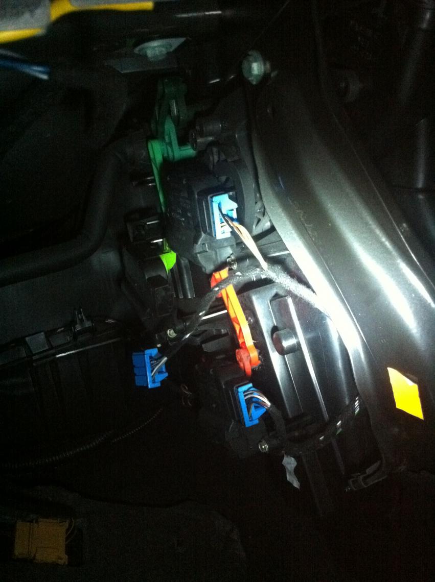

I have fixed my blower.
The motor was seazed/stuck. You need to remove the glovebox with an 8mm socket. There are 5 bolts, 3 on the top and 2 on the bottom. You will also need to remove the panel on the left hand side of the glovebox, using a screw driver.
One these are removed you will see 3 motors on the right. The middle one controls the windscreen vent.
I removed the motor, using a 6mm socket set. I then plugged it into another power terminal for one of the other motors and run through the blower options, after watchign the motor work back and forth i then re connected to its original power supply, replaced the bolts and tested it. i found that another motor was also seized. i did the same with this and....
To my delight it worked. Refitting the glovebox was fairly difficult, but not too bad. i did it all when it was about -2 and pitch black, it still only took about an hour.

I had this. I fixed it
I had this 8 years ago. You have to remove the glove box, this isn’t too hard.
You can then reach in, behind the dash.
Turn the air vent to the floor, then the middle and then the screen. You will see the vents changing behind the dash.
I simply moved them by hand to free them. I also cleaned them, the best I could.
I still have the car car and the problem hasn’t re occurred.
