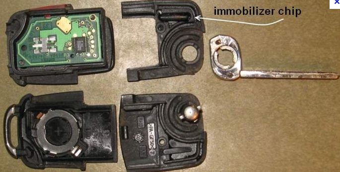

I looked up the blank keys for both 2004 A4 and A6 and the flip style key is the same part number. Both have the same chip inside too, as in the picture below. There is a midyear split in 2003 for the remote transmitter for your A4. So be sure you get the later 2003 and up 4 button remote. Both choices are 315 mhz and 4 button, but the part number is different between the two remote transmitter choices.
Your dealer might charge differently than we would. We would get 143.50 for the whole key (vin cut flip style portion, plus the 4 button remote, these snap together to make one key) plus 120.00 to program the key to your car or it won't start the engine. I called an independant shop in our area and they told me they can't program the immobilizer portion of the key but they can program the portion on the pc board that handles the lock/unlock buttons. Maybe the vagcom experts here can answer if they can program the key or not.
