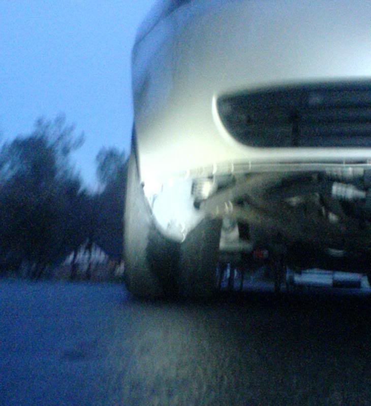

Its not possible to get over 3 degrees negative camber on one side in the front. They apparently don't know what they are doing with the alignment machine. Its also possible that you don't have each side equal with your coilover set up. Take off the wheels and use a tape measure and compare both sides. Even if you messed up big time there is no way you could register a -4.11 on either side. That would indicate your spindle is bent something fierce.

Raised toe is for bump steer, it almost never has to be adjusted un-less the tie rods were changed. Meaning if you hit a bump the steering wheel would try to turn on you if it were out.
Shifting the subframe is how you adjust the camber, but i think they put the wrong settings in the machine which is why it looks like its out a lot. Looking at you pictures i would say its closer to 2 degrees negative on both sides.
In any case, that shop doesn't have a freaking clue what they are doing so your gonna have to take it to another shop. When someone else prints out the alignment for you bring it to the old shop so you can get a re-fund.
