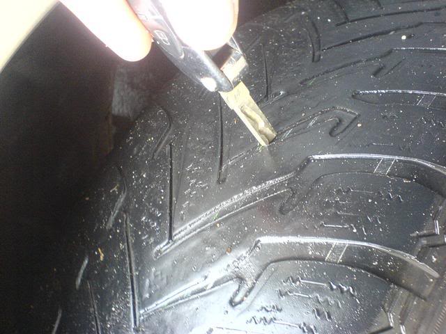

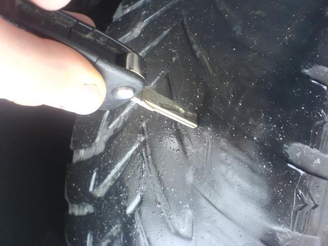

More confusion! I just went out and took a look at my tires to see if the wear is showing any clues about the camber, and can anybody explain this? (wow I really need new tires... NOW)
Here is the passenger side with claimed -1.41ยบ camber, but the outside edge is completely worn and the inside edge shows much less wear. If it were at negative camber, wouldn't the inside edge be showing the wear?
Here is the drivers side with -4.11ยบ camber claimed. This confuses me because with that much negative camber, and being able to SEE the tire slanted like this \, why wouldn't it wear unevenly.
I really want to get this figured out before I put new tires on, but I may have to bite the bullet and get them after seeing how worn these tires are.

Its wearing on the outside because the toe is out. If the camber was -4.11 like they claimed there would be steel belts showing on the inside tire. The print out is bogus! By looking at your tire wear it looks like you just need to equalize the camber and adjust the toe.
