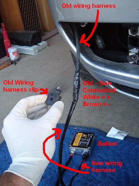

Hey guys .. can anyone direct me to a DIY or explain how toinstalling hid fogs .. I just purchased vvme H7 for my fogs 1999.5 B5 .. ithought it was a straight plug and play for the fogs .. it seems like thepower source for the fogs does notconnect directly to the ballast? Do i need to modify the fog light connect to fit the ballast .. confused ..
I think I need to splice the old wire harness clip (white and brown wires) and attached it to the what i beliwve is the new harness clip supplied in the kit (blue and black wires) if that makes sense .. Then the new clip should fit into the ballast ..Anyone installed the VVME HID KIT for the Fogs?

thewires harness clip of the fog does not fit the ballast on the HID kit .. I think I need to cut and attach it to the clip that was supplied in the vvme kit .. i justneedto make sure if i am correct .. the harness clip has blue and black wires and does if the ballast .. the fog light house is enclosed and will have to drill some some holes and seal it ... i thought the VVME kits was straight plug and play for the fogs .. oh well .. anyone else installed vvme fogs?

thanks for the information .. based on the DIY on you need to cut the old wire harness from the fog lights and then connect it to the new wire harness which plugs directly into the ballast... i had a hid kitfor my 540 which hadplug that fit directly to the ballast ..
hopefully it will be done tomorrow ..
