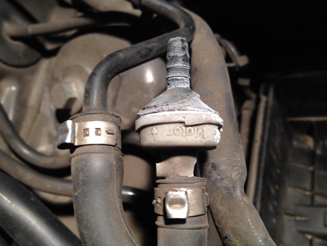

First timer here. Working on changing my MAF sensor and I stumbled across this piece (on the passenger side above the MAF) and it looks extremely corroded and I would love to replace this while I'm changing out the MAF. Any idea what this could be and where I could find a replacement? I have an Audi A4 1.8T year 2000.

looks like a check valve. part# 058-905-291-K
