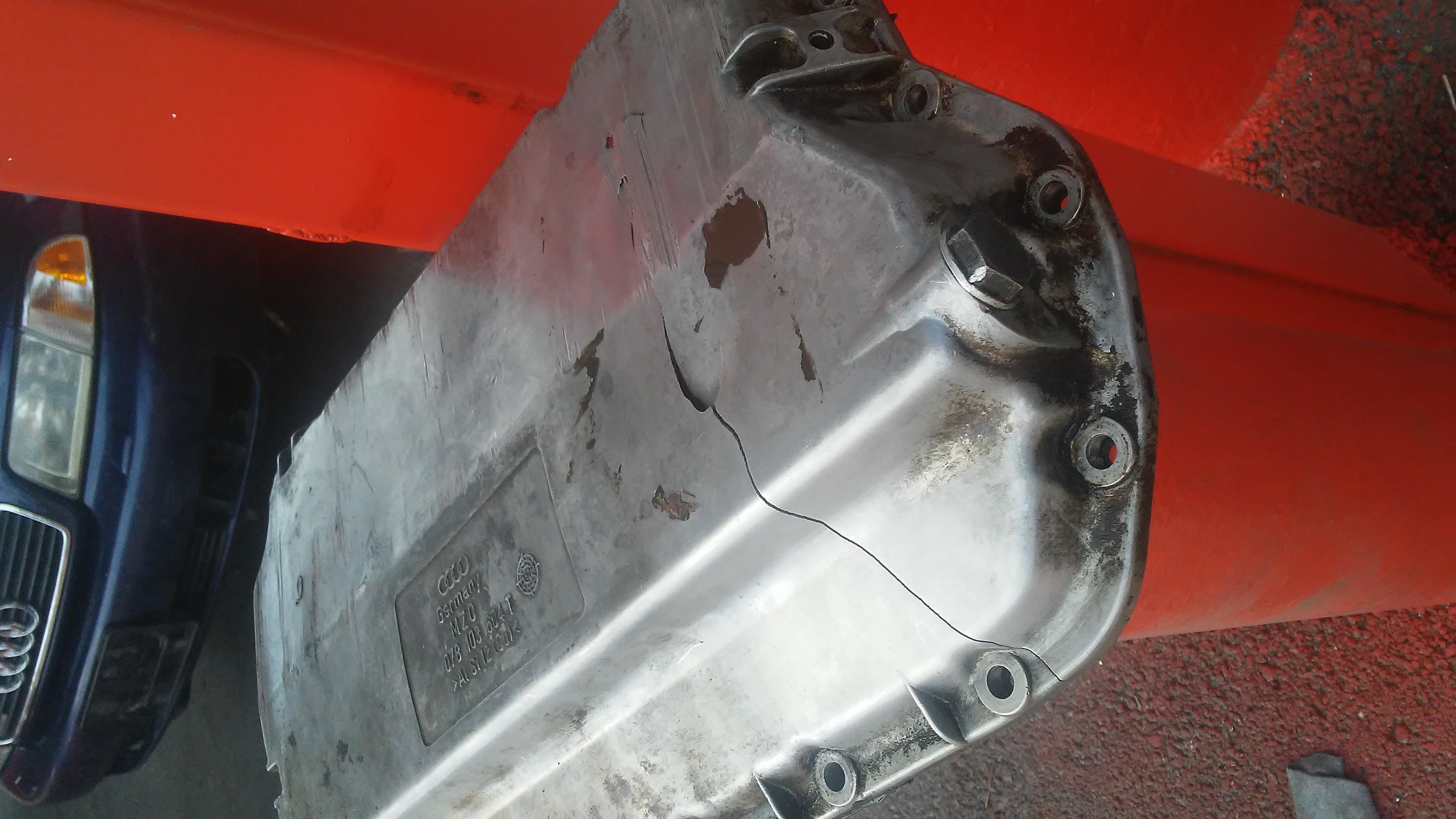

So couple nights ago i was driving at night and i hit a dip on a crossing.. The f****** dip was more like a trench deep needles to say anyways it broke my pan literally broke it leaked all oil with in 5 min. It was a simple fix took me couple hours but i got it temporally fixed JB weld.. Besides the screws that hold up pan you have to remove 2 brackets that hold up sway bar u have to because it block the rear side of the oil pan.. Also a wrench will only do half the job u need a nut driver one that goes in drills 1/4 fitting.. And. Its 10mm
