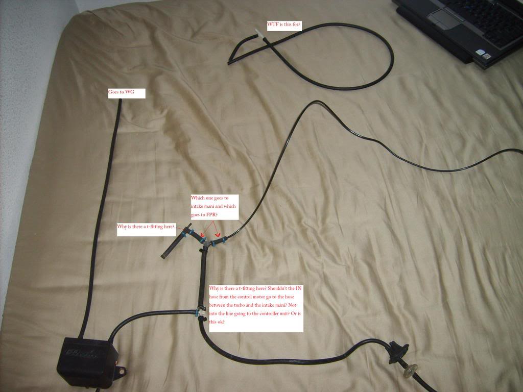

ok so i just bought a profec b since it was only 100 bucks and i wana see what my k04 can do. so now im trying to figure out how this guy did his previous wiring

So is it alright how he did his IN line? and im guessing the top right of the 3 way joint went to a boost gauge (because of the hose used) and then the top left went to the intake mani and fpr. is this alright?
if its alright the way it is, im gonna go install it, if not i'll jus run to the store and pick up some tubing and redo it

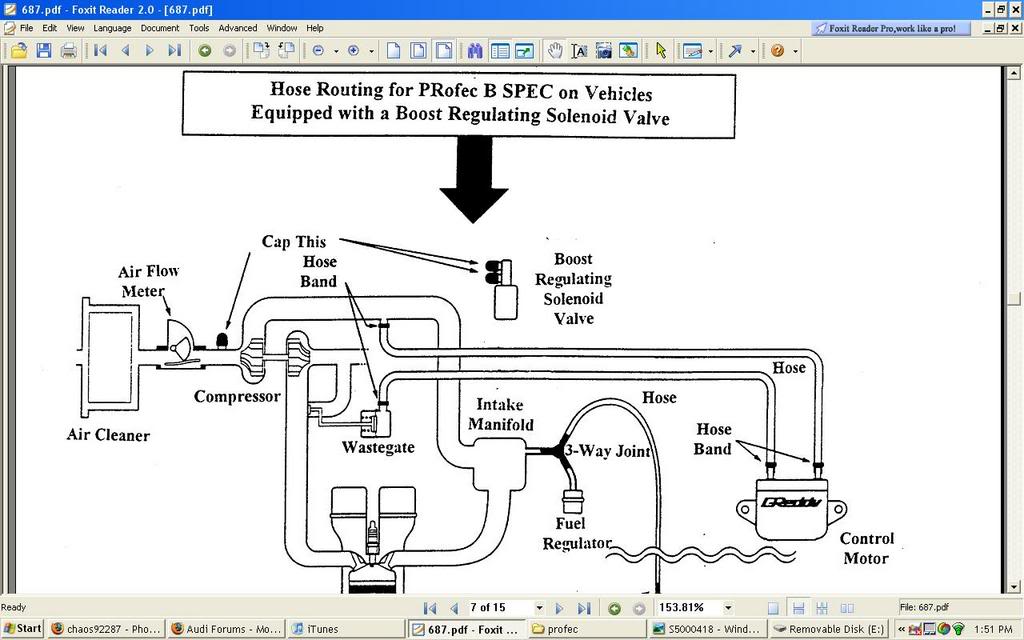

here's how its shown in the instruction book from greddy

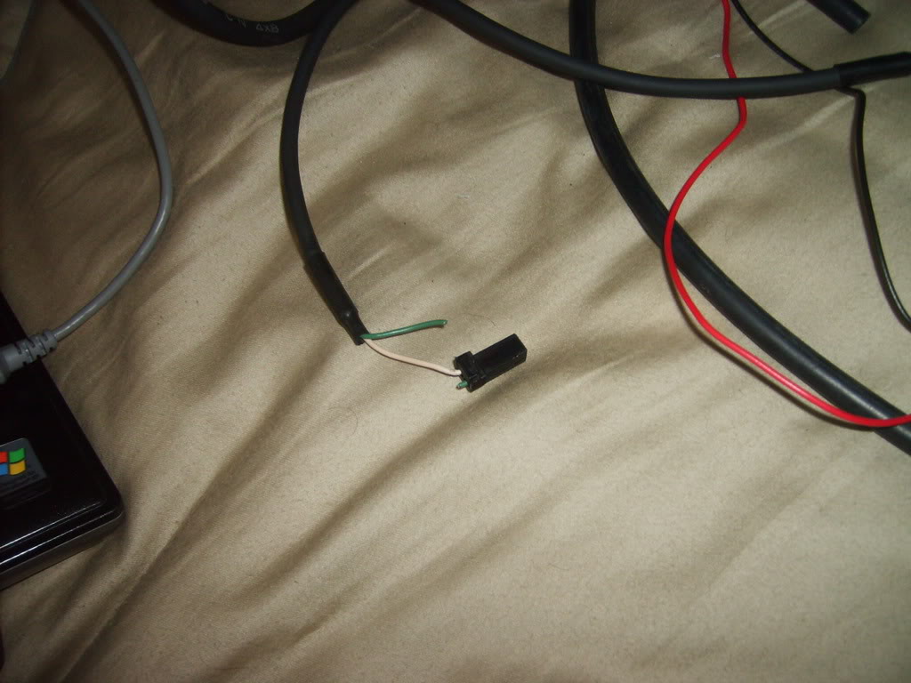

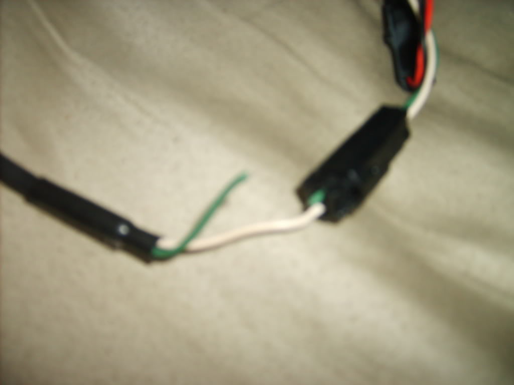

how do i fix this? i cant find a way to open the clip to reinsert the wire...or can i just rip out the little piece stuck in there, and just force the wire in?

try this... http://www.alamomotorsports.com/gred...EC_B_SPEC2.pdf
THe valve unit (bottom left of top pic) shouldnt have a T in it. On line goes where the n75 is and then the wire on the back goes to the controller.
The line with the filter goes from the controller to the fpr buy itself.
Then you just need a ground and 12v source

to fix that wire, just strip the tiny bit left and then solder the 2 back together. Not to hard

FINALLY! thank you cincy. i dont have a soldering iron or gun or anything and have zero soldering experience. is there like a cheap one i can get at Autozone or somewhere, and its really easy to learn right?

You can get it at HD, Lowes, Sears, and probably parts stores. It shouldnt be more than like $15 or so. And it is beyond easy. Just get the wires hot with the tip of the iron and then melt lead onto the wires and it cools in about 2sec and then they wont come apart. To make it even easier, twist the wires a tiny bit and then melt the lead over them. Then just wrap in electrical tape and your done. Just dont strip to much wire with the plastic cover.

yeah so i just wasted 20 bucks. i cant strip enough wire off of the little piece to solder the 2 wires together...so now what do i do?

Heat the remaining rubber on the wire up with a lighterto strip the remaining.

If its just a connector to make things easier, just dump it if you can.
You should have enough, just twist the tips so they barely touch, the solder will make the connection you need between them. WIth a tuner, a soldering iron is a must have.
