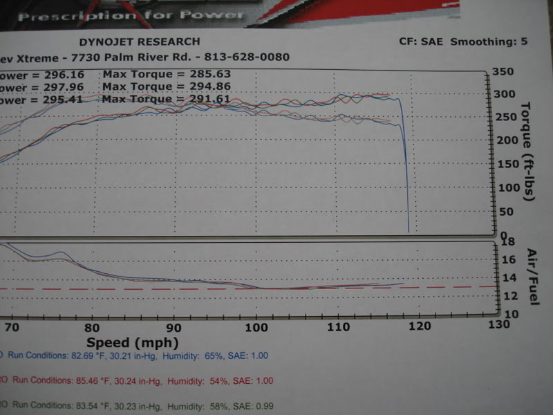

but here, i dug up some dyno's for you
this is a GTRS with a leaking DV(notice the wavy power output)
these next 2 charts are of a GTRS car. the lower number is at 1.8l displacement. the higher number is when it was built to 2.0l
here is a 71r elim on a B5
and finally, here is a PDF of a 71r on a B6. 323 AWHP/327AWTQ---->http://dthaus.com/DYNO.pdf
there is more. specifically a guy that put down 321(410Bhp)Awhp on a GTRS elim. but i couldn't find it.. but these are just the ones i could find off the top of my head

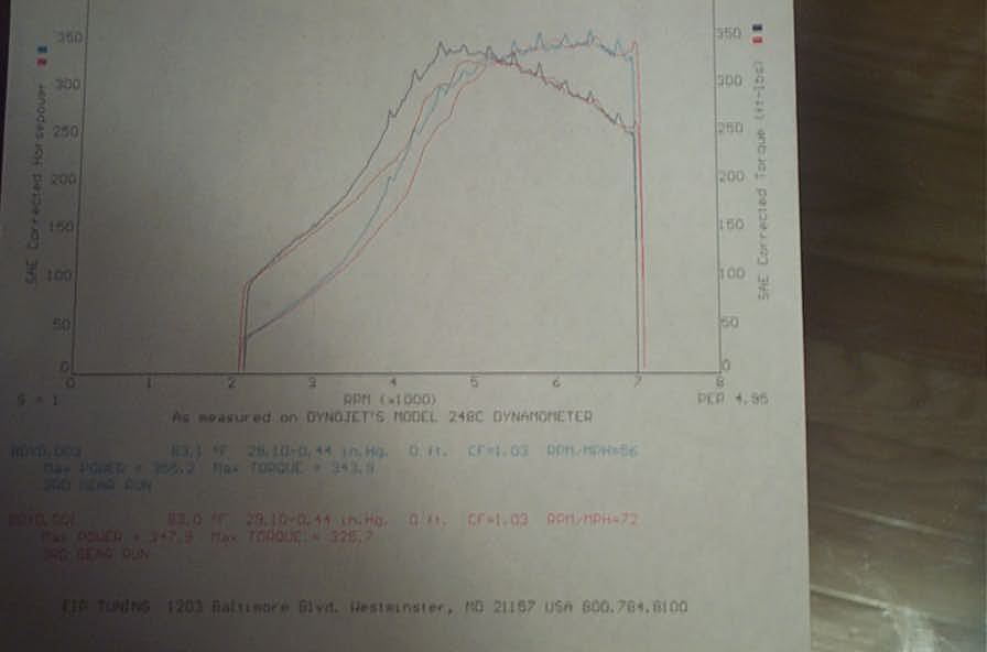

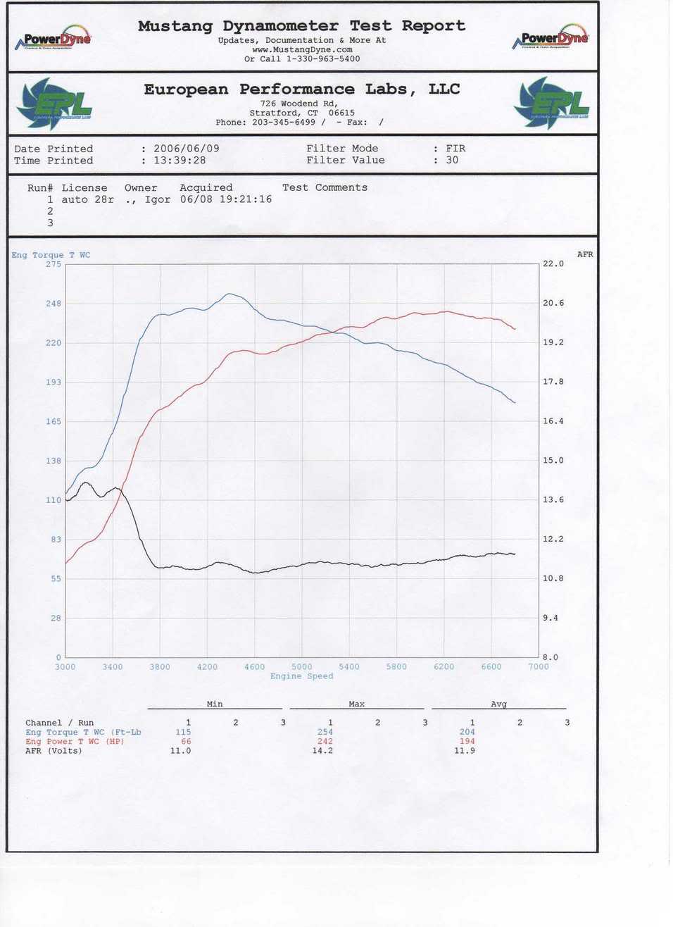

I just like the middle dyno, it shows 3076r type spool but without the power. The first dyno is a little more typical, just shy of 300whp. In that PDF, the power is only over 300whp from 4800 and back below at 6100rpms. You cant seriously tell me that these turbos are worthwhile after looking at these dynos can you? A t25 .64 gt2871r would hit 20+ psi around 3700rpms and make power all the way till 7k+. Which powerband would you think more people would prefer, 1200rpms or 3500rpms?Proves thanits worth the extra $500 or so for a REAL kit.
first off, look at the location of the middle dyno. it's at parker colorado, which is 5000+ ft in elevation. so of coarse it's going to be a slower spool. those numbers are SAE corrected for sealevel conditions btw..
and in the PDF, that guy actually had a full GT28RS setup prior to his 71r(made the change for emissions resons living in CA). he states that the power difference is actually not noticable between the two. look him up. he's had a BT'd A4 for over 3 years. his name is '400hpA4' or 'Greg@DTH'on audi zine.. im not sure what you're problem is with the elims. they have their pros and cons, just like any turbo setup really. there is more than just peak power and spool time
and further more, dyno's are not the end all be all for judging power output. i know you have got to know this. we are not even awareof what type of dyno's most of these are. and there isn't even a baseline dyno of an A4 to compare them too. as well as are we looking at all the conditions of them? like temp, humidity, octane of gas, adjusted altitude? no, we aren't
im with you that a full garrett turbo will of coarse be better for more power output as well as a few other things over the elims. but im not with you that the elims are a horrible option. they suit many people for what they want very well. and again, have been proven MANY TIMES. HINT-look at the trap speeds on all those elim turbo's and compare it with the full GT28RS APR cars in there

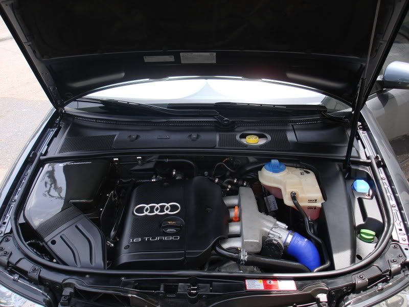

had to go snap a pic real quick..
but, here is a comparison between a GTRSengine bayand my GT28RS enginebay. now these are extreemes, (since he actually has all the factory panels/covers. but just pay a mojority of your attentoin to the turbo portion of the bay)but this shows the difference. especially for people that have strick car moddinglimitations like in California where nothing visual can be different
mine
and his
mine
and his

Apr stage 3+ (gt28rs) No boost given but should be 20-22psi, you see how the power continues to redline? The elims dont do that.
GT28RS (the sheet says 28r, but it's a mistake)
415cc@3bar
vr maf
ATP HW
Nospeed 75mm CB
4-speed transmission
EPL SW 19 psi
STock AWW engine
GT28rs .86 ar
internal wastegate
(Wastegate was set at 6psi to lower EGTS for dialy driving-casuing boost to taper that much)
440 injectors Revo BT sofware
revo settings HB9 Timing 7 on 94 octane
20-22 psi tapering down to 17 at redline
Bailey Diverter valve
EG solid cold air intake
3" inlet pipe
Custom FMIC using ATP tubing
Greddy Spec 1 Boost controller
255 lph walbro inline pump
3 bar FPR
This .86 looks like a elim spool but makes 350whp on a gt28rs
