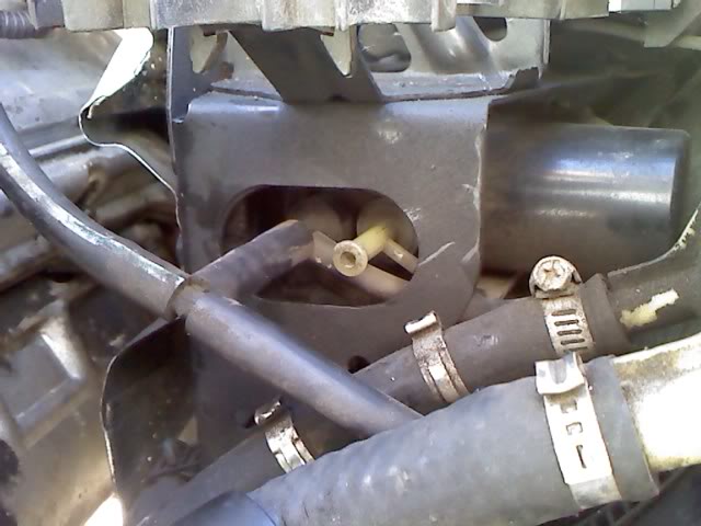

I have this component that I don't know what it i just know its under the abs unit
Neither of these hoses are connected to anything can someone help me out???
