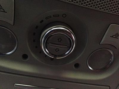

I'm not sure if the Avant is different than the A4 sedan, but I double checked the owners manual today the sunshade is powered. There is an up and down button on the same rotating **** that controls the sunroof that controls the sunshade. Since the sunroof is in working order, this leads me to believe that there is either a separate motor for the sunshade or it has in fact come off track. Either way, the thing won't budge, even if I try to do it manually. Here are some pics....

I looked through the schematics, and on none of the models for your car, can I find a motor for the sunshade....sorry can't be of further help...most of the ones even on the links I looked at are the ones built into the metal frame and operate with the sunroof themselves...interesting....
