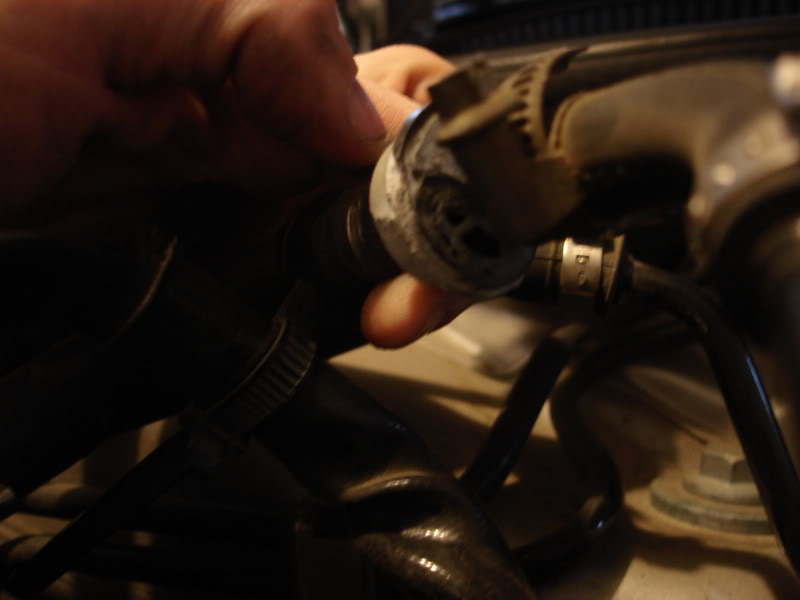

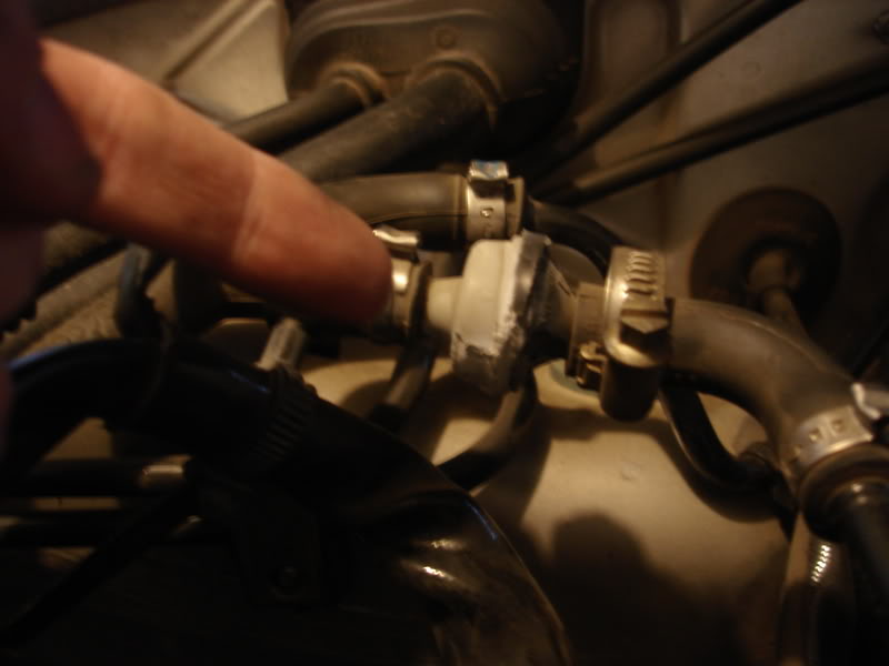

ok, did the zip ties, still getting the codes, started looking over my intake and i noticed this
what is this?Name:  DSC01262.jpg
cause its definatly f***ed up
could this be causing my problem?

Its a vaccum check valve, those can cause a check engine light or an evap fault depending on what line that is.
Old Oct 3, 2007 | 09:03 PM
hiwords's Avatar
Posts: 7,728
From: noob from NY
Default RE: Forge 007 DV vaccum leak issue
he means change the part. just in case u didn't understand him lol
