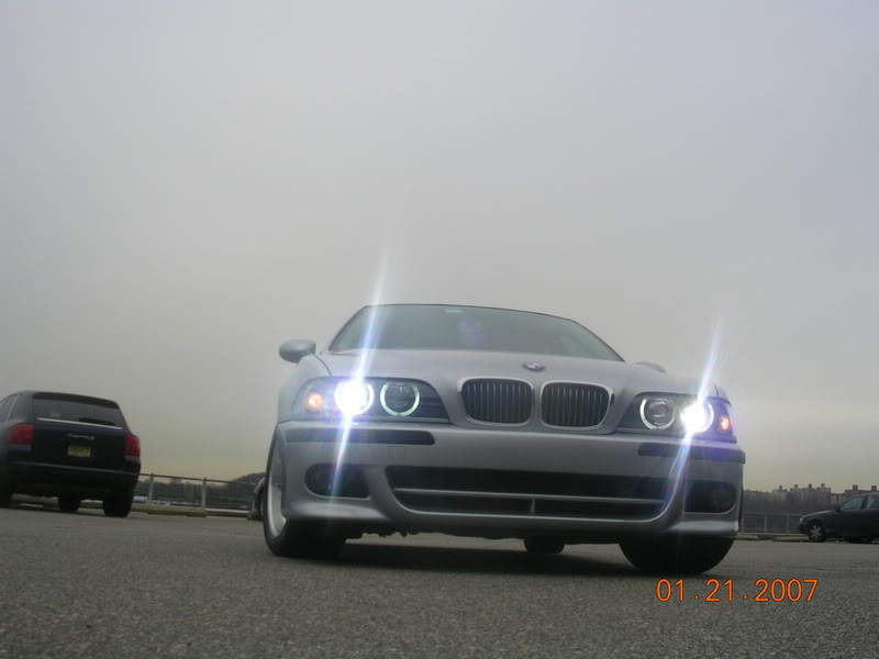

here are my 6000k low and fogs on my 540 .. i think6000k is the best of both worlds ..btw, I am still waiting for my two HID kits from VVME ..Three weeks and counting .. just be prepared for a very long wait ...Hopefully it will be worth it ..

6000k luminosity isn't much less than that of 4300k (the 4300k kit luminosity is 3200 lumens, and 6000k is around 300-3100 lumens, compared to 750 for halogen), so you will have a ton of light intensity with either kit. To me, the biggest difference between the two (I've had both as well as 5000k) is that the color of the 6000k kit, which is definitely more blue than the 4300k but still not really blue, makes it appear to be more of a difference in output than it really is. Still, there is a noticeable difference between these two color temps, and for max output, you're best off with 4300k.
