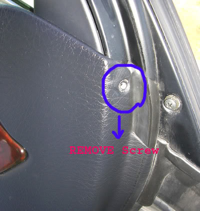

There are two Phillips screws to tackle first.

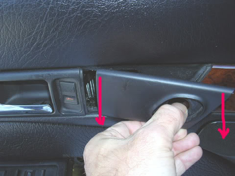

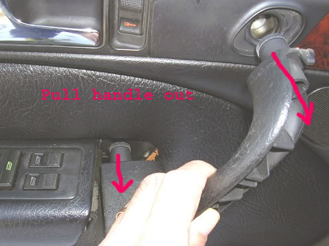

Next, the door handle should come out, as it is mounted via two screws fastened into the door frame assembly. Press the top of the handle cover and down toward you, as it will snap loose. Then just pull it out toward you.
Remove the two Pillips head screws and pull the handle out.

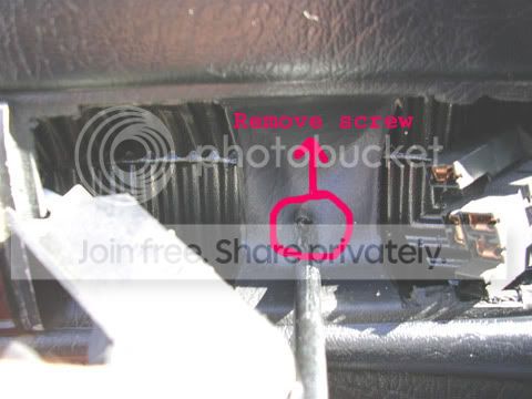

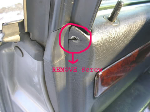

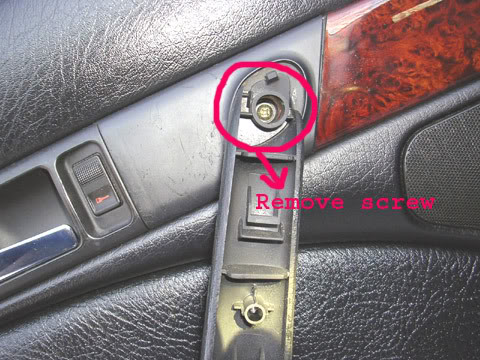

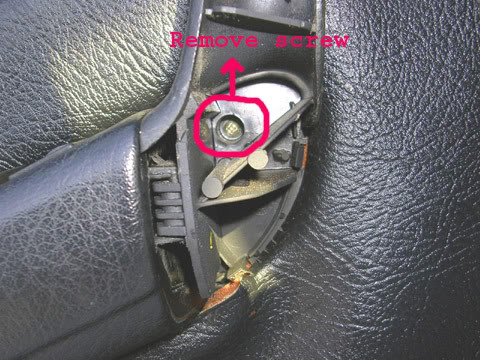

Pull out the door latch (handle) and locate the screw behind it. It is the last screw holding the panel to the door frame assembly.

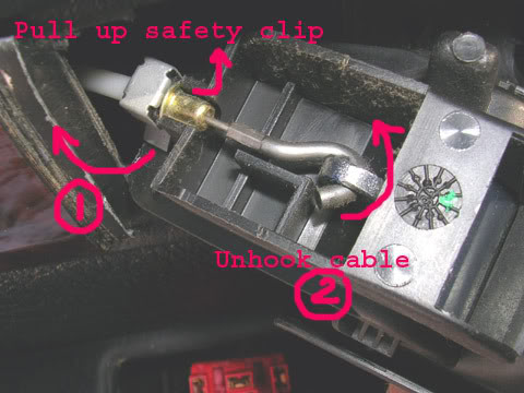

Now, turn the latch (handle) unit and unhook the cable. As seen, the cable is hold in place by an additional safety metal clip that just snaps out.

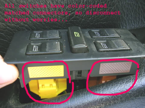

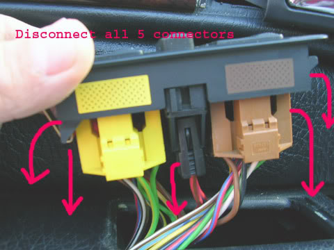

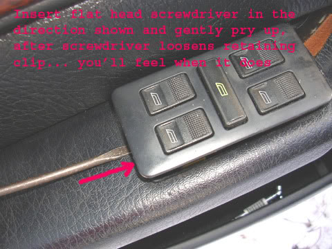

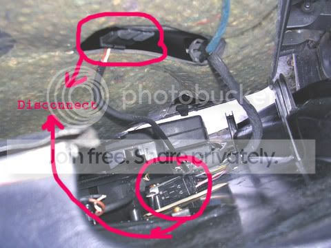

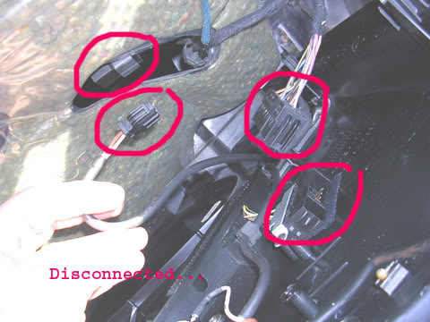

Next move is to detach the window switch unit, because the harness should be disconnected from the panel. Insert a flat head screwdriver gebtly and push toward the front of the car. You'll feel when the safety clip that holds it in place snaps loose. At the other end has two retaining tabs.
The connectors are color coded and matched on the switch unit, so no need to jot down the order for reinstalling.

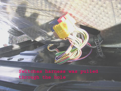

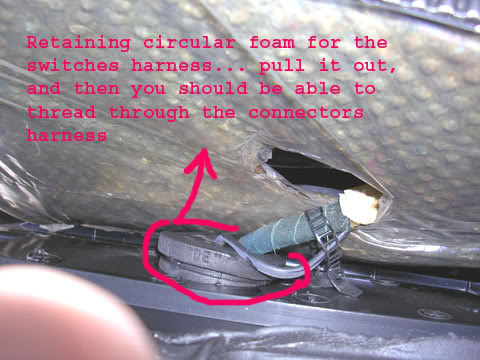

Now we need to pull the switch unit harness out of the cover panel through the opening, after taking out the retaining foam in the opening.

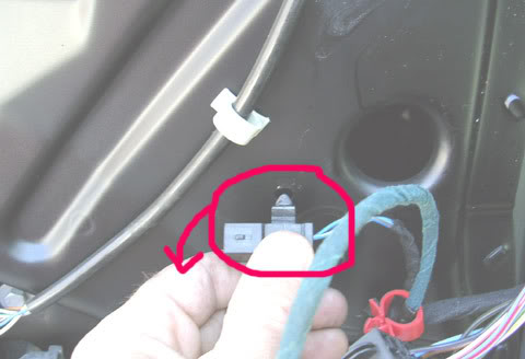

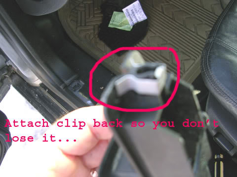

At this point you can pull the panel up over the safety lock pin, but you cannot detach it, since are more power connectors to get unhooked.

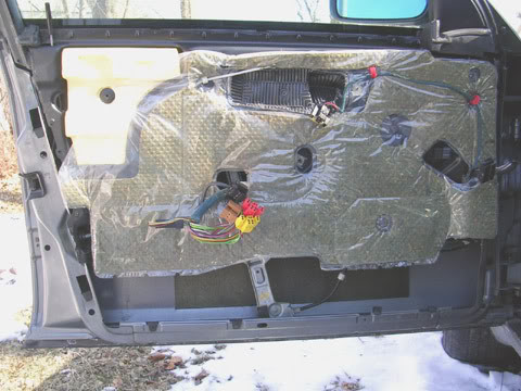

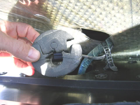

Next, the insulation has to come out. If you can work around it, please do so, but there is some wiring fastened with plastic clips that needs to come off, so you might as well take it out.

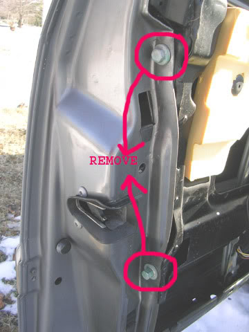

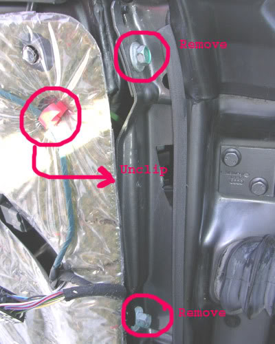

There are four 13-metric nuts that hold the door assembly frame fastened. Removing those is the first step.

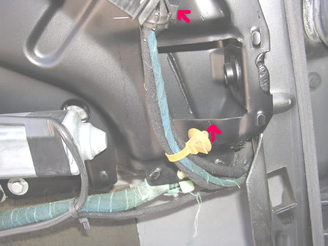

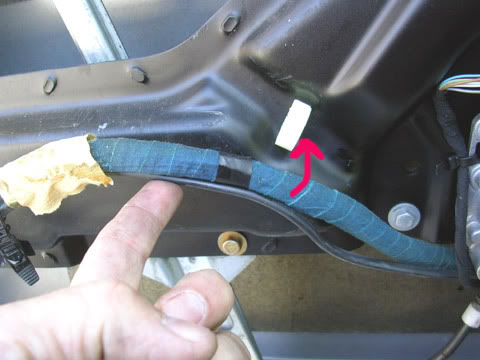

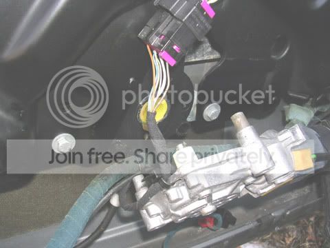

As I said before, there are several wire harnesses hold by plastic clips that need to be unclipped. This, along with the motor removal will free the assembly. I couldn't figure out a different way to do it.

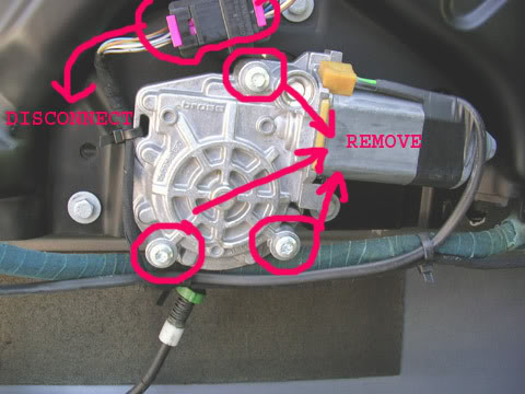

Last step is to dismount the motor. It is fastened via three T-30 screws.

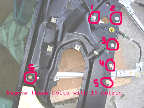

Start by removing the 6 10-metric nuts that hold the regulator connected to the assembly.

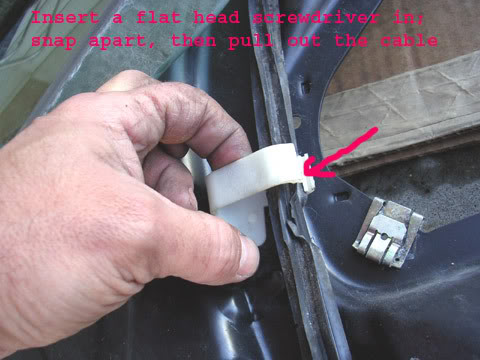

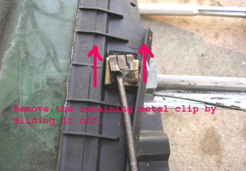

Unclip the retainer seen in the picture that holds one cable fastened to the assembly. Insert a flat head screwdriver on its edge and snap open. Pull out the cable.

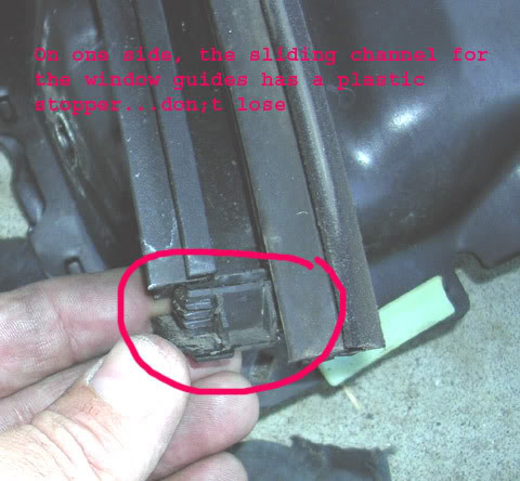

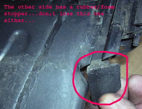

You can now slide the regulator + window assembly out of the weatherstripping channels. On the bottom, there are two stoppers, as seen in the pics. Don't lose them.

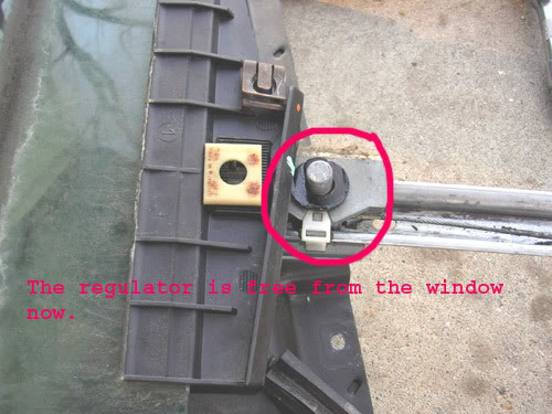

Next step is to detach the regulator from the window. The two are fastened via a safety metal clip that slides out. Use the flat head screwdriver as seen in the pic.
If you started with the window up, make sure the connecting tip seen below is at the highest point on the regulator's track/channel.

I would like to say "Thank-you". I could not find the screw behind the handle until reading your post and EXCELLENT pictures, too BTW!
