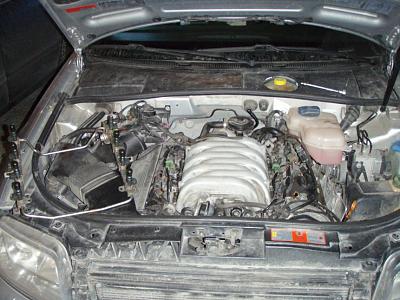

Next I guessed that the fuel injector was bad or clogged on number 8, once I saw the price of a new one ($150 was the cheapest I could find) and figuring that if one was bad, the others were probably close, that it would be better/cheaper to have them cleaned and balanced. I pulled the fuel rail, pulled the injectors, and sent them to fuel injection connection. For around $125 they cleaned and balanced all eight. I re-installed them, and ughhh, P0308 again.
Engine with fuel rail removed.

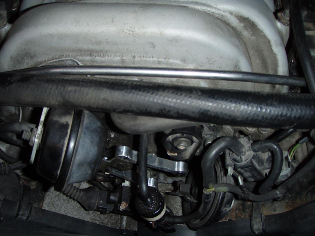

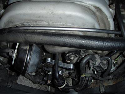

I then turned to the bellows type secondary variable intake crossover valves at the front of the manifold. I had noticed in the past that one of the plastic arms was broken and had replaced it with a gruvenparts aluminum one.
Notice that one is actuated, the other is not.

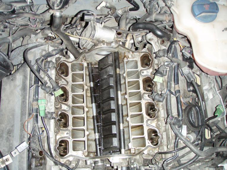

However, I realized that the reason the other one broke, was that the valve was stuck. I tried to manipulate it by hand to no avail. I tried cleaning/lubricating the crossover flaps with throttle body cleaner through the TB, but it was still stuck.

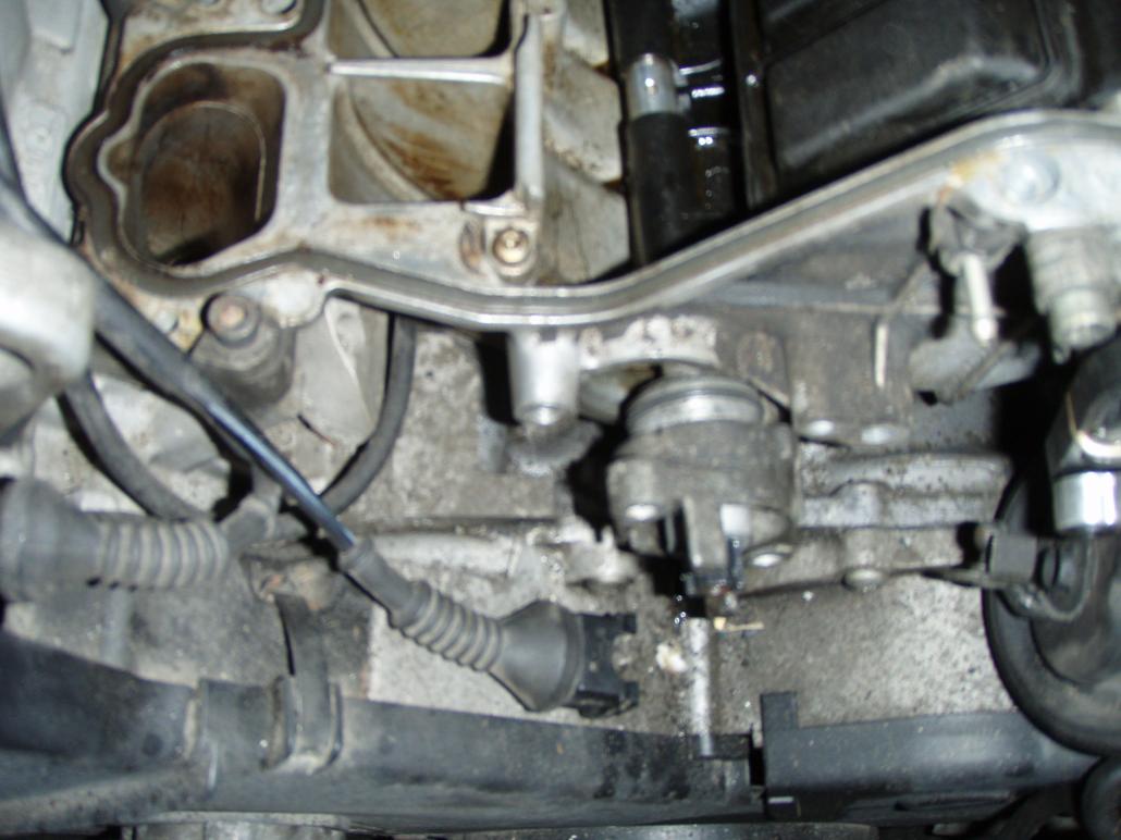

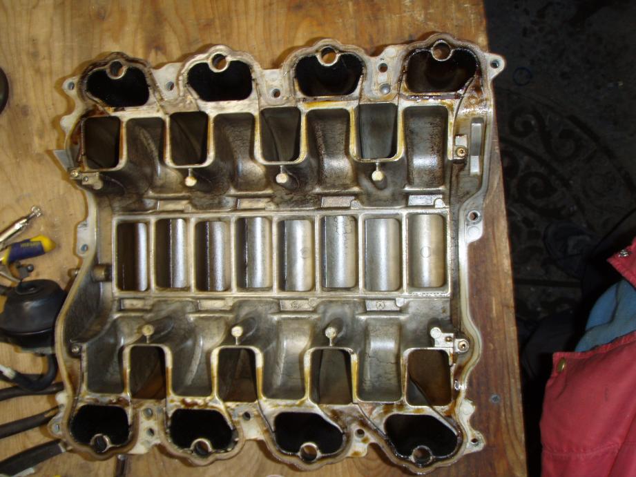

I removed the manifold cover, and secondary variable intake actuators and found the flap to be completely seized.
This is the inside of the manifold cover, removed.
The flaps are plastic, so you don't want to put a lot of pressure on them. I pulled the seized one forward about an inch to release the pivot out the front of the manifold, then cleaned, lubricated and reinstalled.
Notice the cylindrical pivot slides out about an inch, but no more. Enough to clean and lubricate.
It now activates and returns with ease. Bolted everything back together and the variable intake now works as intended.
Variable intake crossover flaps.
The P0308 code disappeared, as a bonus I have increased power and mileage, and the engine is much more responsive thanks to the other items replaced during my attempted fixes.
