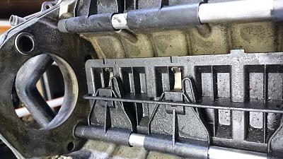

OK so just so you guys can see from the inside. The actuators will only get stuck on the front of the engine and is relatively easy to correct the issue. I just happen to have a spare engine minus a few toasted valves.
Attached Thumbnails 2000 A6 4.2 Quattro - Intake Manifold Actuator Seized *Open*??-dsc_0441.jpg   2000 A6 4.2 Quattro - Intake Manifold Actuator Seized *Open*??-dsc_0440.jpg
