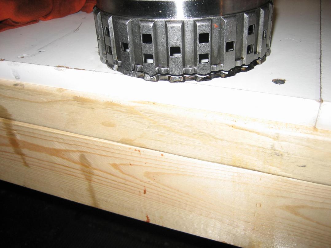

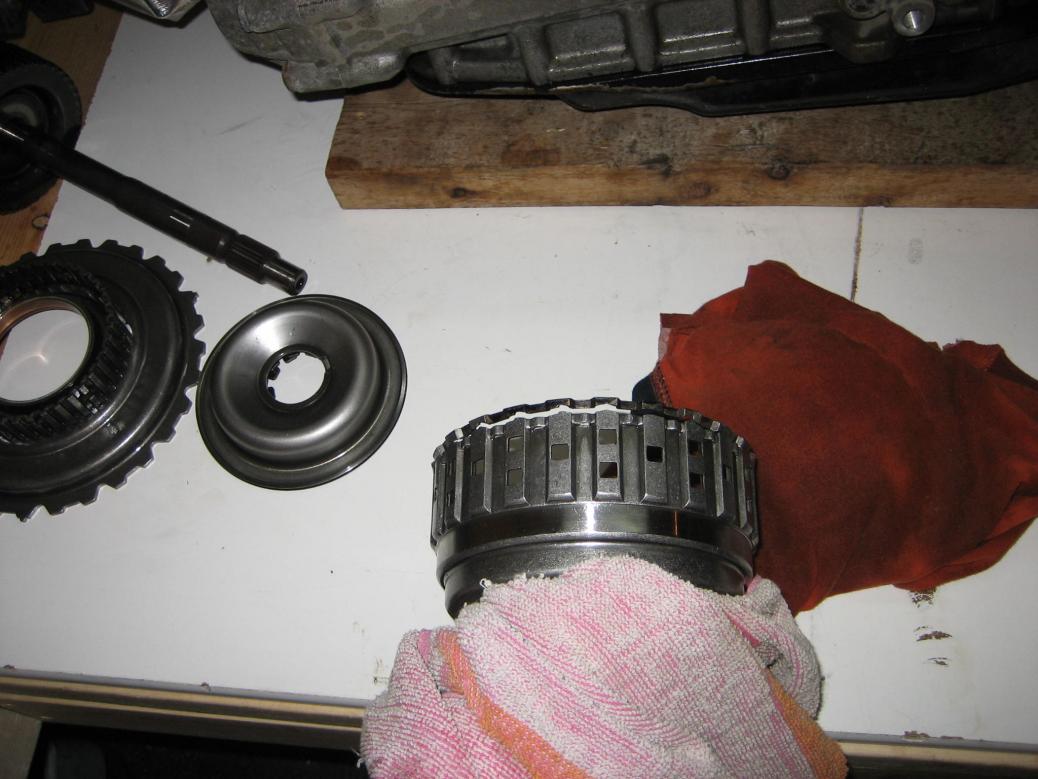

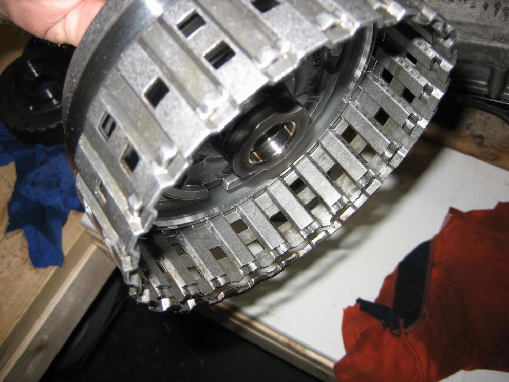

Got the transmission out on saturday and split it apart last night. The removal of it was actually pretty easy, i have definately had to do a lot worse. The hardest part was figuring out a way to support the engine to drop the support cross member without the use of an engine hoist. Once that was done, I had the transmission out on the floor in about 4 hours. The dissasembly was another hour and a half. The one thing that made this removal so easy was a transmission floor jack that I borrowed from a friend of mine, it really made the transmission come out fast. Now that I have removed one of these I can honestly say that anyone with a decent set of tools, some basic technical knowledge and a good common sense can pull one of these transmissions without too many issues. An impact a set of impact allan sockets make this job that much easier.
Well, found the problem with my car. The culprit was a split A-Clutch basket . As I mentioned the car was in an accident which is most likely what caused the damage. As per the attached pictures you can see where the basket split where the clutch plates retaining ring is located, obviously the weak part of the basket wall.
Now here is the hard part, other than the dealer, can someone suggest a shop that might carry one of these used in the US. Finding used Audi parts up here in Canada is next to impossible, expecially internal stuff like this.
In hind sight I should have torn the tranny apart before spending $900 US on a rebuilt torque converter and a master rebuild kit, but oh well, you live and learn.
I really appreciate any help.
JR
