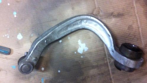

OK - Bentley book came yesterday. Upon closer inspection, the passenger side lower rear guide control arm is bent. I found an awesome YouTube video done by the Bentley guys.

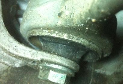

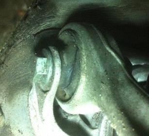

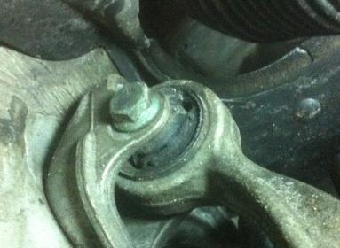

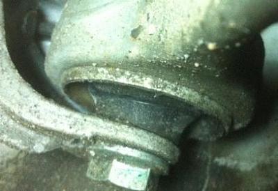

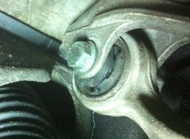

So I have removed the bent piece. It does not appear as though the front lower control arm is bent and from an eyeball glance, the tops seem good......except I notice cracks in the rubber bushings on both top control arms ON BOTH sides. I'll try to attach pics in a next reply.
Should I replace all of them? Or is this one of those common"they crack but are fine like that for a long time" item?
