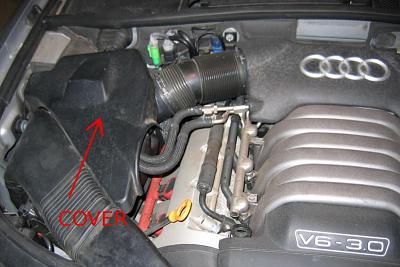

In case you decide to replace purge valve see pics:
remove the cover by lifting up:
2003 A6 V6 - fault code P0441 / 16825 - purge valve replace (pics)-simg_a.jpg

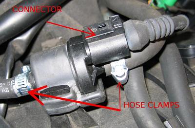

2003 A6 V6 - fault code P0441 / 16825 - purge valve replace (pics)-simg_b.jpg
disassemble the electric connector and 2 hose clamps and remove the purge valve:
2003 A6 V6 - fault code P0441 / 16825 - purge valve replace (pics)-simg_c.jpg
Assemble in reverse order.
