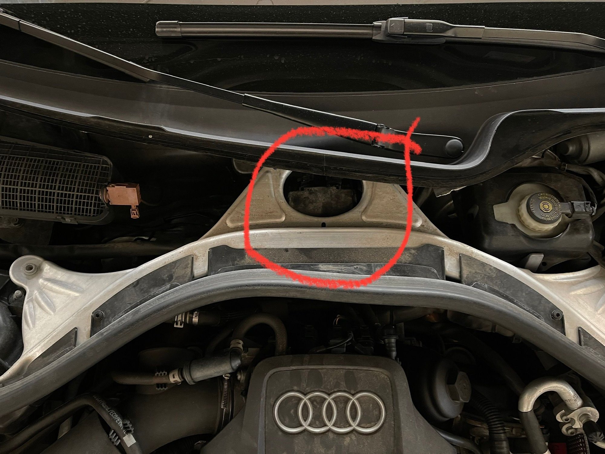

Quote: Fellas, thanks for all that you guys shared here. Two days ago I noticed that when I came to a long stop my AC no longer blew cold air. I looked under the hood and noticed that both my fans were not working. Prior to that though I noticed that only one fan worked, I just thought that the computer turned the second one on when it was hot enough. Back to the issue at hand, once I came across this forum I looked for my 40 amp fuses and discovered that they were both blown. Picked them up for 11 bucks and installed them. AC wokes like a champ now. I wouldn't have been able to have done it without this forum.
Thanks guys
Juan
Same issues with AC not blowing cold at stop and fans not working. Temp gauge usually sits at half but starts to creep up at long stops. No issue when moving. Can someone tell me where to find fuses? The area circled in red? It doesn't look like Matt's setup and I can get in there to see....
Reply
Jun 2, 2023 | 02:44 PM
  #16
Quote: Same issues with AC not blowing cold at stop and fans not working. Temp gauge usually sits at half but starts to creep up at long stops. No issue when moving. Can someone tell me where to find fuses? The area circled in red? It doesn't look like Matt's setup and I can get in there to see....
Figured it out and removed the silver crossmember and found the exact same problem - two blown fuses. Ordered them from AutoHaus and now wait to install them. Dealer quoted me $3500 for fan replacement. If the fuses solved the problem, done at $14. Shocks me that Audi dealer doesn't know about this or just wants the high buck repair!
