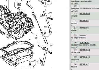

I came across this article some time back.
Leaving that aside, after looking on Vagcat it looks like the Automatic 4-speed trannys can be retrofitted with a dipstick. It's just my opinion.
The filler tube would screw in the fill plug.
