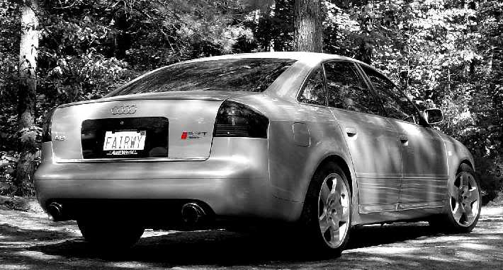

I sold a set of the 5-spoke 4.2 "sport" wheels to a friend of mine with a 2.7T (lowered with the Eibach pro-kit) and he had rubbing issues with the 255 40 17 tires. He switched the tires to 235 45 17 and no more rubbing. I had a set of those wheels on my 2.7T and I loved the look!
