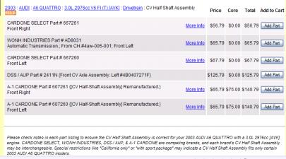

Check for your curiosity RockAutoParts, and get informed on prices from other sites as well before throwing at the mechanics whatever they ask for.
Chefro, thanks for the link.

Thanks for the link- but I guess you need to guide me now what to do and where to go (in NYC) after purchasing this part at low price. If I take the part to the same workshop how much labor should I pay. If they might charge me $100 or more labor for replacing it, the total comes up around $200 again. any suggestions / advice is appreciated. thanks.

However, even if you don't (want) to go this route, you should shop around before making your decision. I would assume you can find at least 20 shops in NYC that do work on Audis. Knowing now the price of a NEW OR Remanufactured axle gives you a better leverage in finding a shop, whatever shop you decide to take your car to.

Thanks a lot buddy. IT should cut my cost of relacement to half if I find a reasonable shop. On the other hand I think I will try to do it my self-
